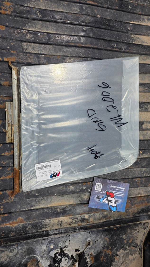

I need to replace a broken out side window in my '63 F250. What's the basic process? I don't have a service manual, and I already have a replacement window. I've done them on lots of different cars and trucks, but I figured I'd get the lay of the land before diving in.

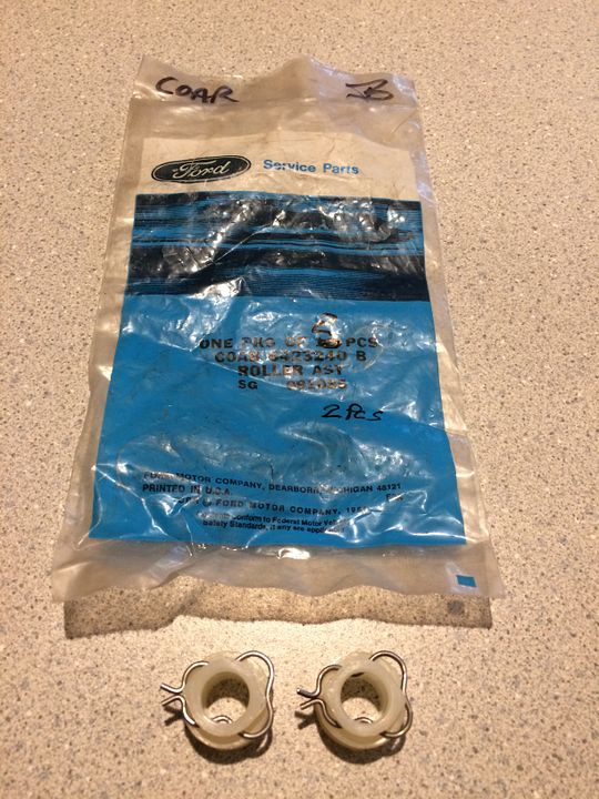

The regulator has a plastic roller with retaining clip that holds the window lift channel to the regulator that looks like this.

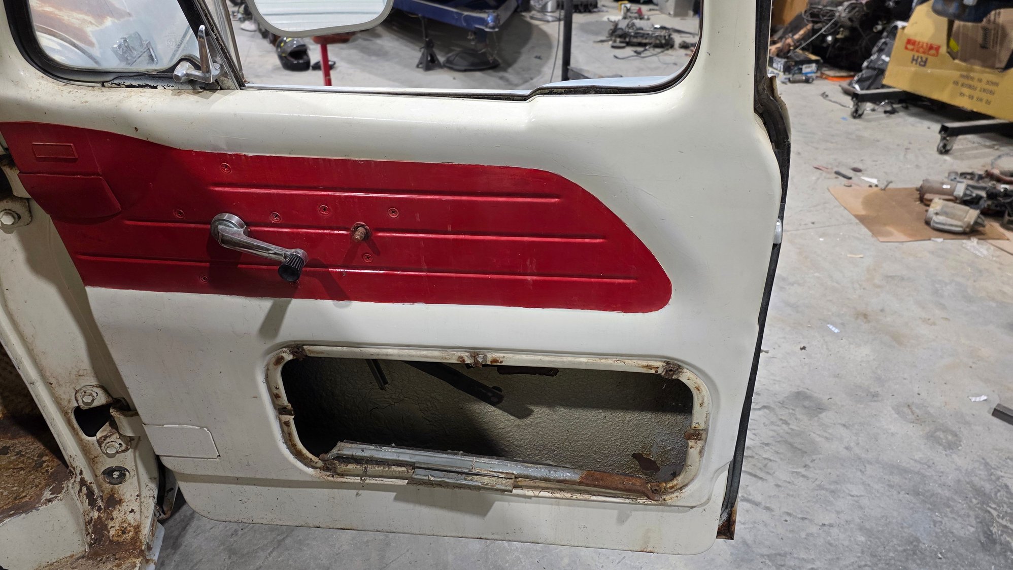

If you roll the window down and remove the large inside cover or map compartment from the lower door and look inside, you'll see it. By removing that clip from the roller then the regulator arm can be slid out of the center of the roller. Once you do that then the window can suddenly drop down so I usually already have placed something inside at the bottom of the door to help pad it like a large towel. I roll the regulator arm back up out of the way using the window crank like normal. Then you have to remove the 2 nuts from the lower division bar retainer just above the door panel opening so you can pivot the division bar forward slightly to release the window from the channel it rides. Then maneuver the window out of that same lower opening. It's a little bit of a tight fit but that's all there is to it.

Thank you! That actually makes perfect sense. I can assure you my first thought was not that it came out the bottom. I'll tackle it tonight when I get home. Maybe even take a picture or two to share with the class.

As expected, channel was laying in the bottom of the door. New glass did not come with a new one. Am I correct in assuming the channel should be set as close to centered as possible on the new glass?
