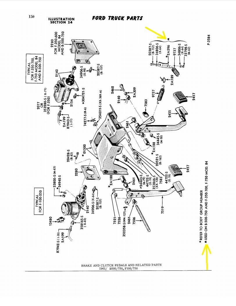

Hello, could you tell me where this bracket is attached to which the brake pedal return spring is attached? If you have a photo, I don't have this bracket, thank you in advance !

You sure that is not the clutch pedal? Hard to tell in your picture what pedal that is. I also dont see any line(s) from pedal to the brake master rod to show it is the brake pedal.

Greetings again!
You are not seeing the full picture - or at least you are not sharing the full picture. These drawings often represent many series of vehicles. This drawing covers F100/250 as well as B500/750 and F350/700 and F750 Model 84. B is for School Bus and the others are larger trucks in the F series so would not apply to your truck. That bracket *2A296 is for the other trucks. The other way using 2A189 as the connection point for the spring 9737 is for F100/250. So that should remove any concerns, I hope. The character ◂ is the clue. Now, I'm not giving the whole story, but I don't want to muddy the waters beyond that.

Oh dear, I absolutely hadn't seen this triangle and the information that refers to it... now it remains to be seen where and how the 2A189 is attached.

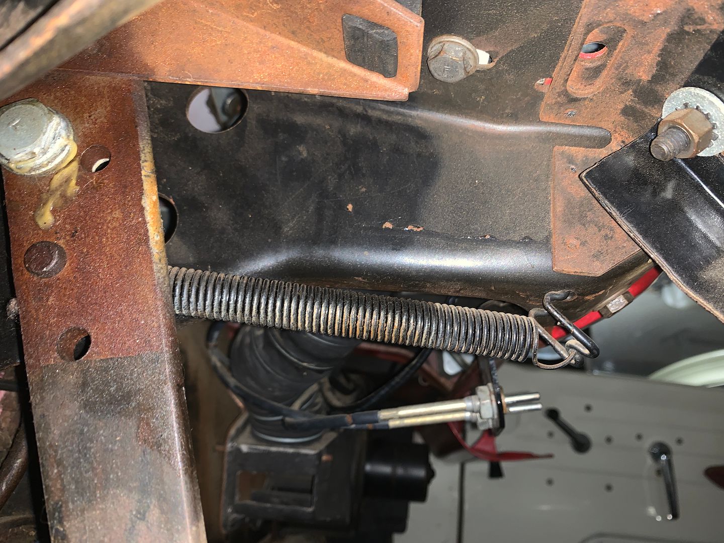

I'll go out right now and get a picture for you.
Once again, a very big thank you !!

That little clippy thing (2A189) can fall out if there is no spring tension on it, did yours make the trip to France in place?

Exactly right. Often the spring would break after years of use and once it does then the clip could fall out onto the floor. A person might not even realize it was there or where it went.
C1TT-2A189-C - CLIP - BRAKE RETURN SPRING - 1 each - 1961/69 F100/950, NT850, T700/950
Obsolete and no NOS available that I can find.
So, the rest of the story is that larger trucks used both setups - in essence two return springs. At least in theory.
