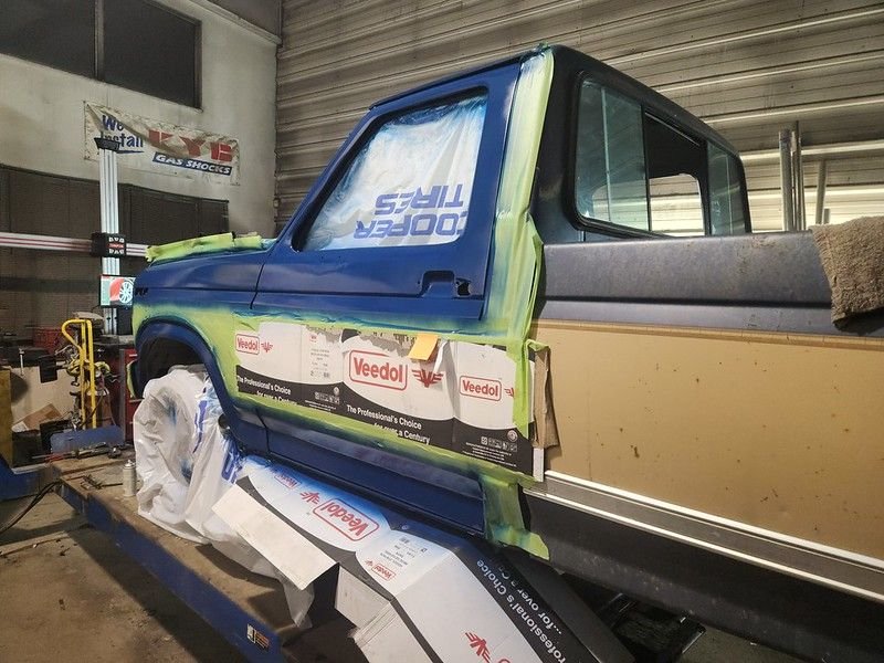

Hey all, been away from the forums for a bit, life got in the way. Just wanted to share how awesomely well the old '86 took a deer. Hit it with the LF corner, then it bounced and hooked its head in my mirror. It must have rolled 20 times once I finally stopped, then he got up and ran away. Bugger.
It doesn't translate to picture well, but the door was completely unfixable. Completely twisted into a U shape, even bent the regulator.
Found a "decent" door and a great fender. Pic of my Ukrainian bodywork in progress.
I sure love being able to fix something like this for a couple hundred bucks, rather than total off a vehicle.

Sorry to hear about the hit but looking at the door it looked like it could be "suction cup" back into place other than that top body line as that is a sharp edge.
You say the regulator was bent but the doors do not have crash bars in them and that outer panel is pushed out into the window parts.
What the cup would not pull out a stud welder would do the job on the sharp edges. Same with that front fender, stud welder and pop that dent back out, a little mud and done.
Around here you cant find parts for our trucks and if you do they are most likely worst then what you got so you were unlucky and lucky all at the same time.
Now that the fender and door look like new when you doing the rest of the truck

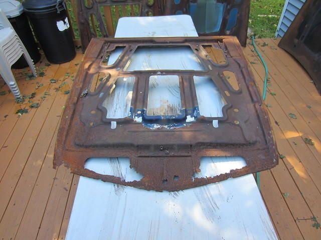

This is the Eastwood black encapsulate I used on the inner hood frame. I also did the underside of the hood skin and the underside of the front fenders.
This was done after I repaired any rust as the Javelin hoods are known to rust the hood frames.

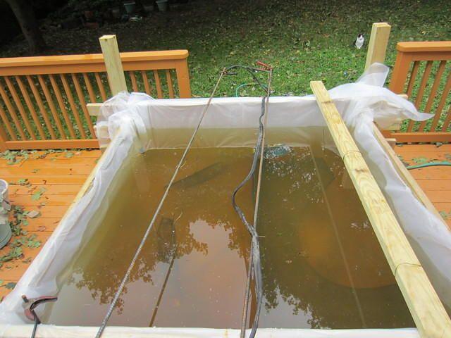

I had 2 hoods and took the best of each and after a soak in the pool to remove the rust and repairing the rust on the good parts and encapsulate parts of the frame & under side of the skin I joined them together and painted.
I used the spray frame coating with the long hose on a buddies Javelin hood that was in great shape and we did not want to have it look like mine so I coated it.
It is a oily liquid type stuff and can drip into all areas and never dries. I have a can if the spray & hose somewhere for coating the frame of the Javelin some day.
