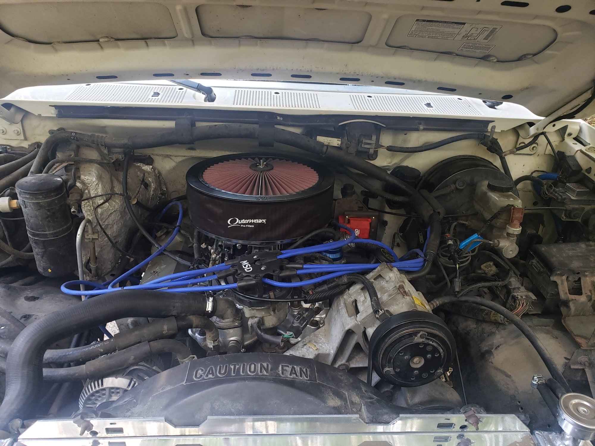

I do have their intake and throttle body. I installed it at 77k miles and I'm at 133k now without any issues. I grossed 19k lbs from Alaska to Michigan and then to Tennessee with it. There is a noticeable difference in power & throttle response. I had 35s and I was getting 10.5mpg. I changed to 33s and after recalibration my speedo I was still getting 10.5mpg. I have factory size on it now and I get 11.5mpg at 70mph. The crazy thing is that I get 1mpg better towing my enclosed trailer empty or loaded than my 2022 Godzilla gets towing the same trailer.

And I still find it hard to believe that a smaller throttle body and drawing hot air from that open air filter gets better mpgs than the bigger OEM throttle body and cold air intake.

The factory setup was a slug. I removed the thermactor, EGR and air injection. Added an adjustable fuel pressure regulator and put a 180F thermostat in it.

I originally cut the horns inside my factory intake and didn't notice anything. Then I got an adjustable fuel pressure regulator and didn't notice any change but it did run smoother. I replaced my coil with an MSD coil that crapped out after 90 days just outside the warranty but I wouldn't want another Chinese MSD coil anyways. I'm still running my 30 year old factory coil. I also have my original TFI module on the truck. I bought the ported intake and throttle body along with a 180F thermostat and advanced the timing to 13degrees. I removed the emissions BS and from the first time I drove it you could tell a difference. Then I installed a set of Banks headers without air injection and the full 3" to 3-1/2" exhaust. It woke it up even more.
I also eliminated all of the clutter on top of the motor and replaced all of the vacuum lines with coast guard approved rubber fuel supply hose. I do have a tuner that is no longer available that tells the computer the EagR is there and functional so I don't get any check engine lights. It isn't like bolting on a supercharger but it did makee a difference in how it ran.
My fuel economy didn't drastically improve but it did improve. I've ran 87, 91, 93 and the fuel economy difference is negligible. I get the best economy with clear gas whether 87 or 93 both are available by my house. I also don't mind buying it even if it costs $10/ fill-up.
