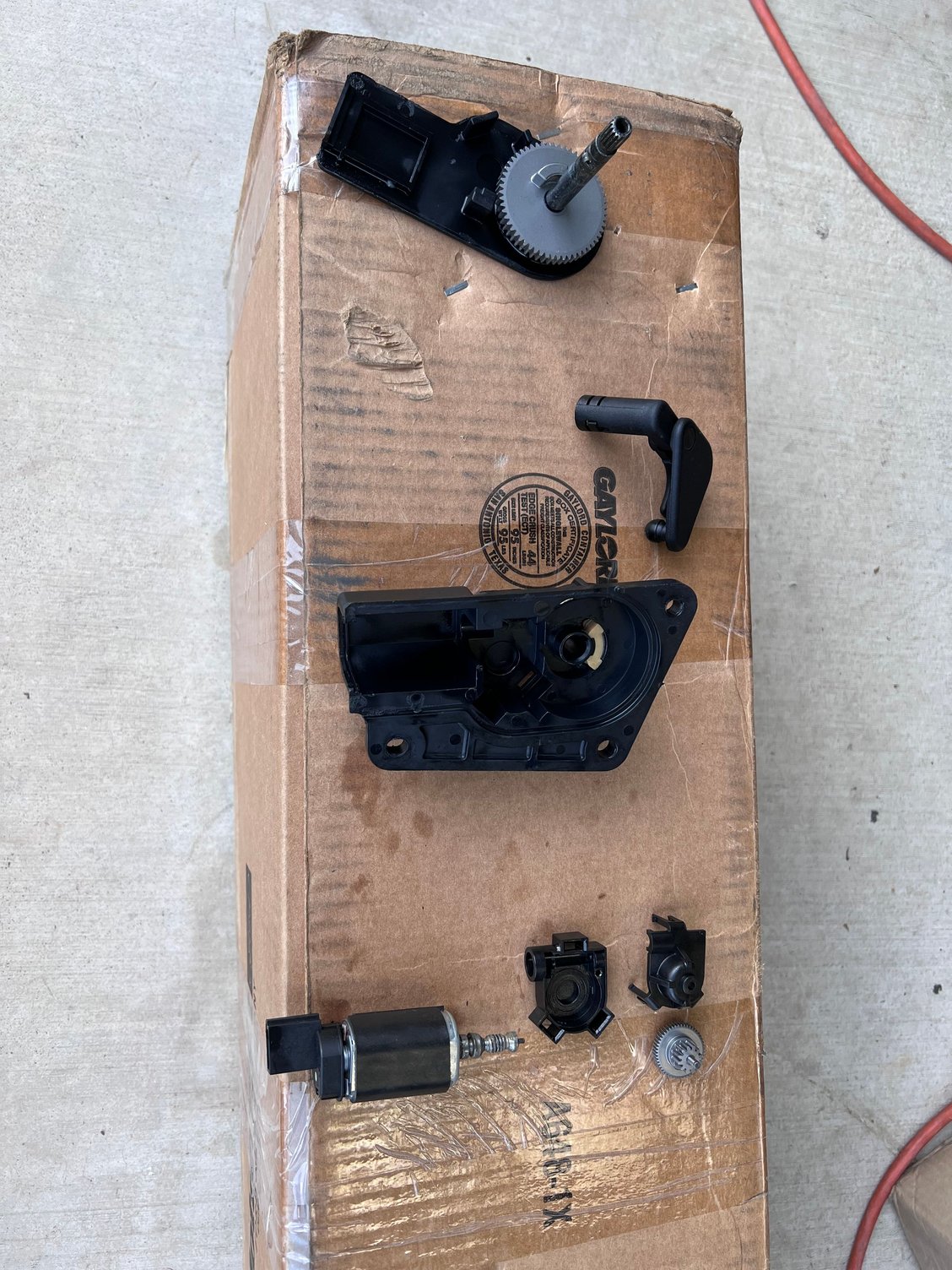

Old Sep 19, 2025 | 09:47 PM

Originally Posted by 01__Excursion
Looks doable. My driver side has that squeal. Probably starting to go bye bye. The passenger side died the other day. Fortunately I found the passenger NOS. I’ll dismantle the old one before tearing the driver side.

Old Sep 24, 2025 | 07:09 AM
01__Excursion's Avatar
01__Excursion
Joined: Nov 2017
Posts: 3,096
Likes: 534
From: Rock Hill, SC
I never saw any king of limit switch in my motors. In my pics above that yellowish rubber dog-bone is travel stop for that large gear. All the noise comes from the motor rotor it's self and I could not remove the rotor from the stator housing unless I pressed the worm gear off the shaft. I still have some Radio Shack TV tuner cleaner/lube I sprayed in the motor housing openings. This made the motor very quiet.
