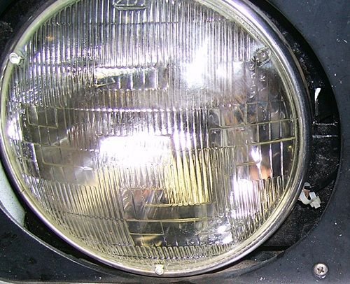

I decided with earlier darkness coming, it would be a good time to install that headlight relay kit, so I proceeded. Took the grill inserts out and went to remove the sealed beams to reach the plugs to disconnect them and I found that of the three screws holding the rings on each bucket, only two were doing any holding. The third or lowest screw on the lower portion was free turning on both. I found that nearly the lowest third of the bucket was badly rusted away, including that tab for that loose screw. Guess over the years since 1977 water getting in when driver in rain did it's deed. I can get it all back together tomorrow as the headlights were still held securely by the ring. I can even use a small wire or zip tie at that third screw hole for a little more support than was there.
No doubt though, the time is coming I'll need at least one more headlight bucket (
I have one really nice OEM spare) but I'd take two. The mounts are fine (but I have one of them too) as they can get windage, but wind that dries water probably doesn't get between the sealed beam back glass and the bucket.
I recalled that I knew last replacement was some rust in the bucket, The rectangle bracket that the buckets sit in are the same right & left, but the buckets differ a little I see. I guess I should replace the springs while doing it, maybe adjustment screws too.

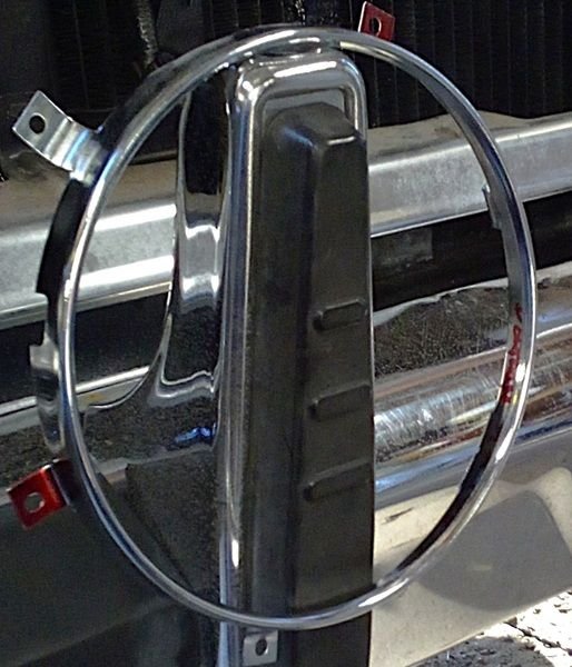

10-08-2025 ..........And Thursday (today), I decided since I want to make use of the Unity lights, was time to put them on. Wife was gone shopping with a friend. While I was at it, seemed like a good time to swap in those good headlight buckets too. I took the grilles out, was "getting into it". Once I removed the headlights, it was easy to grab the spring near the hook end with small vise grips and unhook them, then work the old rusty buckets out. One even partially collapsed as rust had weakened it, was worse than I thought. My "new to me" buckets slipped in easy on the adjusters, then I just grabbed the spring and hooked it. I did clean my bucket mounts and paint them. I was stumped then as both head light retainer rings had a tab come loose where they are electro welded at a factory. No way for me to fix that except replacement.

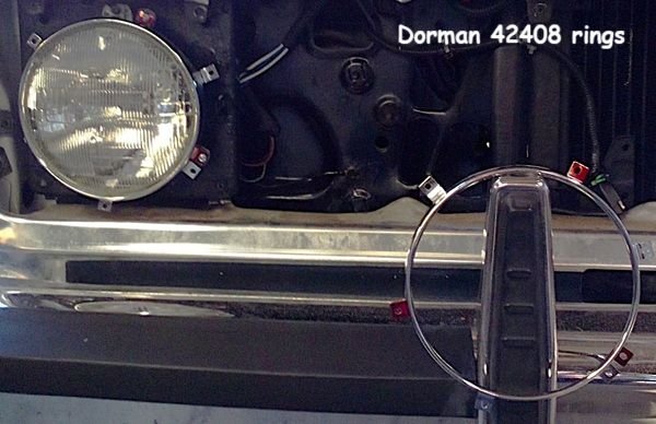

I got on the computer, found Dorman made a universal ring, pt # 42408 has 7 tabs, and it was said to fit, but calls locally pointed to "not in stock" .... but I found out was 3 at Advance Auto Parts up the road in Staunton, where my Wife just got back from shopping. Oh well, ain't but 40-45 miles round trip. Wife was already dressed, etc., so off we went, back to Staunton.
I wanted to compare the universal to my originals. I got there, looked them over, compared them, and 3 of the 7 tabs matched the 3 on the originals, AND the Dorman tabs were not welded on ... they were cut somehow with the whole ring before forming. I bought 2 and come home to install them, good fit, only cut one un-needed slotted piece off. I even used the longer screws. They are chromed steel, not a magnetic stainless steel.
I colored the 3 matching tabs red with a sharpie, & I just colored the 4 unused tabs with a black sharpie to hide them. The tabs are not just "attached", they are "one with the rings".
Put the grilles back in, they don't show unless you look for them.
I thought about cutting the excess tabs off, but decided not to. I'll put the fogs on tomorrow (Friday) then. The longer screws Dorman included are not #10-24 like OEM used, they are like a #10 sheet metal screw. I was gonna use the correct 10-24 ones, but a couple holes in my "new to me" buckets had stripped threads, but a squeeze with vise grips tightened the holes up and the Dorman sheet metal like screws were used.
