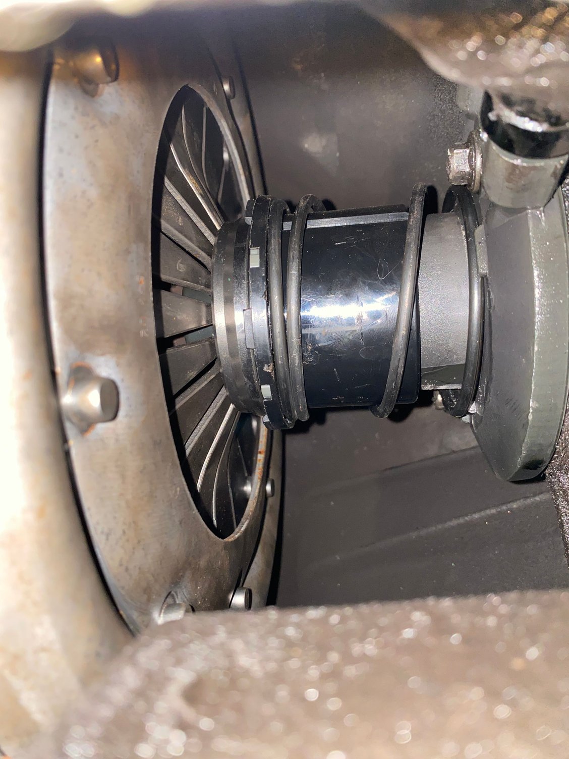

Old Sep 17, 2025 | 10:34 PM
TobyB's Avatar
TobyB
Joined: Oct 2014
Posts: 949
Likes: 187
From: Carnation, Wah
Get someone else to push the pedal while you get the camera on the secondary cylinder/diaphragm spring.
If the spring doesn't invert, yep, you've got air!
I too have faith in the 'stomp the bejeezuz out of it' method, because in a fit
of frustration, that's exactly what I did- and it worked. And has, since.
But you have to bleed as much air out of it as possible at first, to get some initial
fluid movement.
