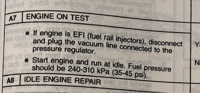

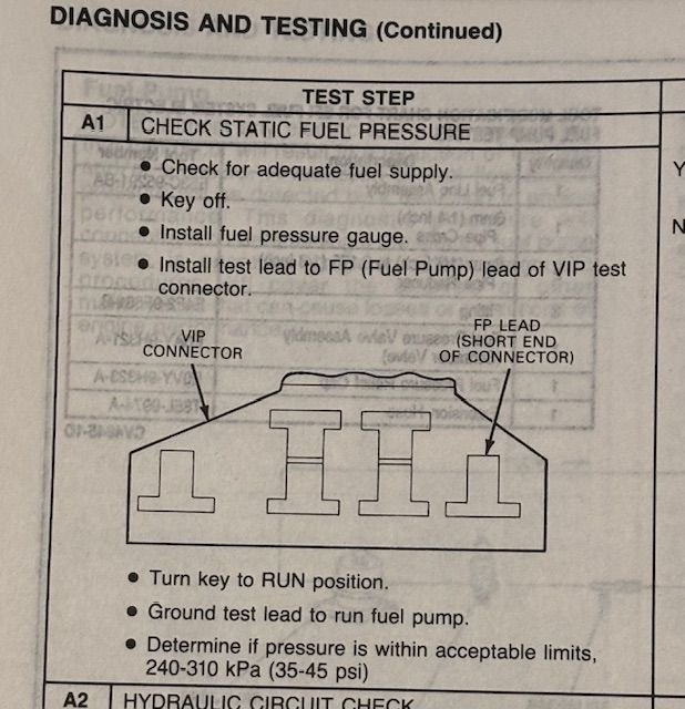

According to the ‘89 Ford Service Manual, your compression is too low
and the fuel pressure might be too high
depending on what 40+ means.
