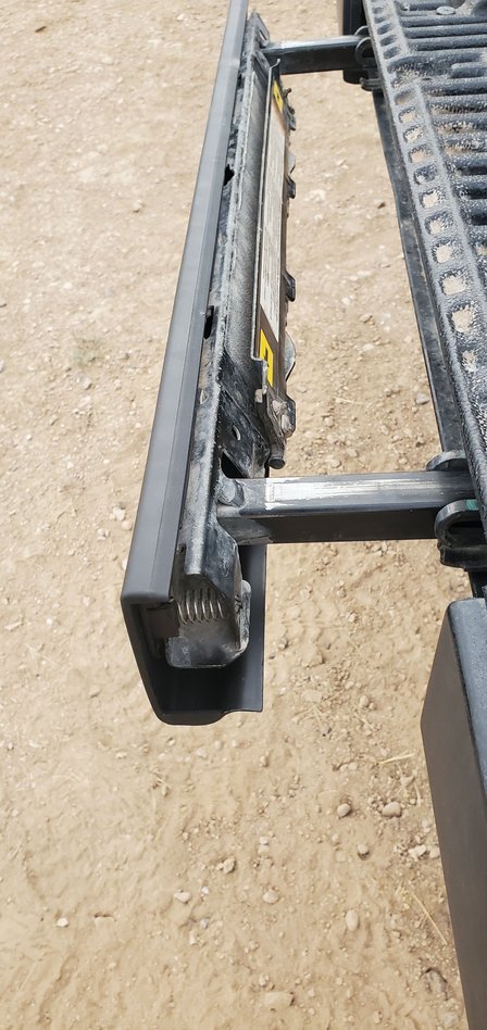

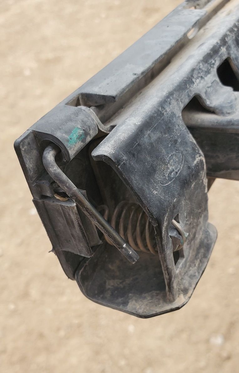

The plastic cover broke off of the step 2 weeks ago when using the step.
Bought a replacement off of Amazon.
Super easy to change by pulling the 2 long rods. Reused the springs.
Put the new cap on, reinsert the rods, connected springs. Just like new. Roughly 10 minutes to change out.
