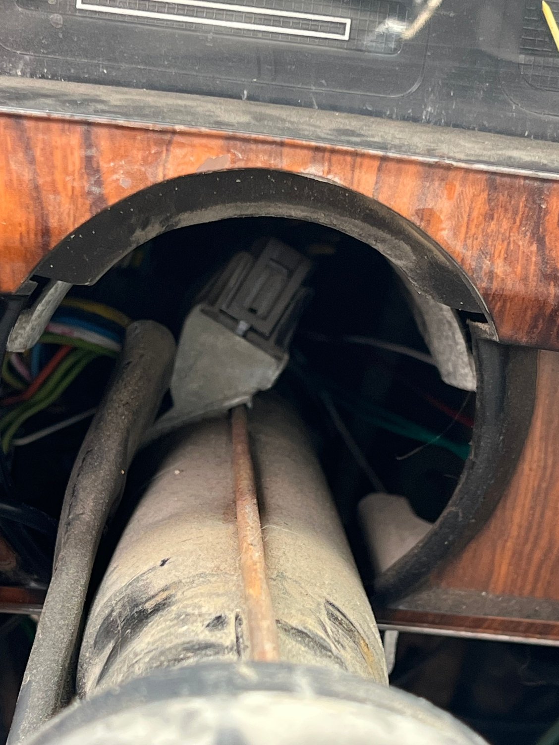

So out of no where today after installing a new battery and wiring in my new alternator, when my key goes to ignition, the starter engages. I swapped solenoids and it does the same thing. Would this mean the ignition tumbler/barrel is pooched? There is a very fine line between ignition, and the starter engaging on the ignition spot. Roll the key forward to start position and nothing changes.

Ignition switvh adjustment
Ignition switch part 2

So I disconnected the “trigger wire” or S on the solenoid, and the key does all that it should minus starting the truck. Something here is triggering key in ignition to power the starter

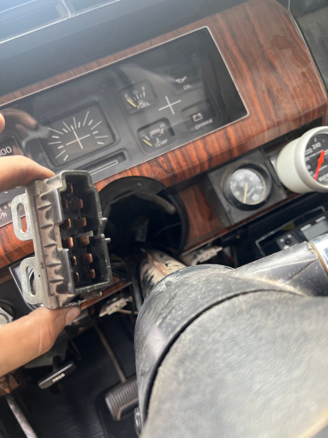

Hey Dave, after fiddling with the adjustment, the end result is the same, thinking it’s an internal failure

I thought the same, I checked and checked again. I went to a 150A 1 wire internally regulated Alt, And ran the 4ga wire with a mega fuse to the battery rather than the solenoid. I will admit, the power wire to the solenoid off the post of the battery was no good, I saw 4V at the solenoid causing it to click about 10 times a second. Will messing around I did have an arc on the solenoid between power and S. I just pulled off the ignition switch and moved it around with a pick after I tried some adjusting ( it was tight and hadn’t looked like it moved, how ever I was definitely old ) and it felt gritty between Off, Run and start positions. When I say gritty, I can hear it, and I can feel it. Really hoping that it wiped out the switch rather than a short somewhere

This is what the ignition switch looked like, relatively clean, but again, definitely felt gritty when sliding through positions when removed
