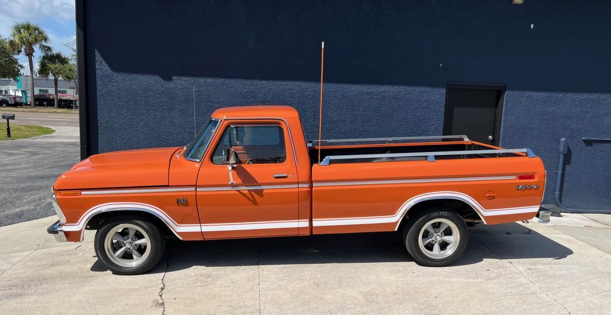

I run 17" x 8" American Racing TTO (Torq-Thrust original) wheels and Firestone 235-60x17 FR710 tires. The tires are the same diameter as the stock H78x15 tires that came on the truck, so the speedometer is accurate. The wheels have a satin finish rim and gray texture-painted spokes. Can't get a much more "classic" look than this.

Looks great! Those are the rims I’m looking at. I wasn’t sure about what profile to go with on 17’s.
