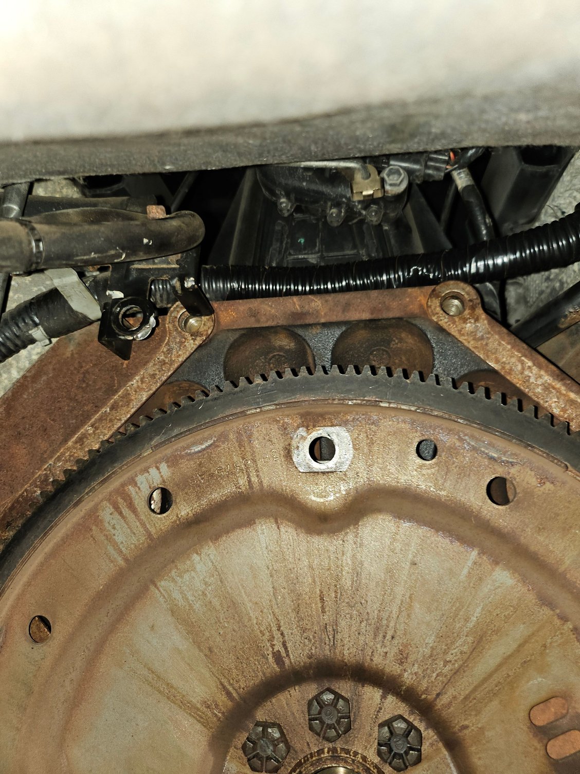

Well I dropped the transmission down today . I can consider myself lucky I actually only smooshed two of the wires in the harness that runs across the top of bell housing. They were the wires that go to the downstream 02 sensor. I was able to repair them and tuck them back in the harness . I finessed the harness some to be sure I won't do that upon installing transmission tomorrow. I used some really neat inline wire splicers that not only shrink wrap the wire but also solder the wires together in one shot. Pretty happy . Just want the check engine light to be gone.

Old Sep 14, 2025 | 12:28 AM

Be prepared for issues in the future, those butt connectors that self solder are known for breaking ..causing high resistance errors..

Oh no don't say it. You gotta be shi__ing me. Now I'm totally flustered I didn't put it back together yet.
Unfortunately AI also agrees with this assessment.

Well ....I'm going to be the guinea pig here. I went with my fix as shown . I read conflicting stories from junk to pros and military that use them daily.
I did practice on bench with some scrap wire and there is definitely a learning curve. After 2 or three trial runs i was satisfied that it's as good if not better , definitely neater. I ran voltage thru the test wires and saw no voltage drop through 2 inline connectors. And I also had to get her done today this is my company truck. I will keep all posted if they give me trouble. Wish me luck I sure don't want to remove transmission again in my lifetime. Lol
