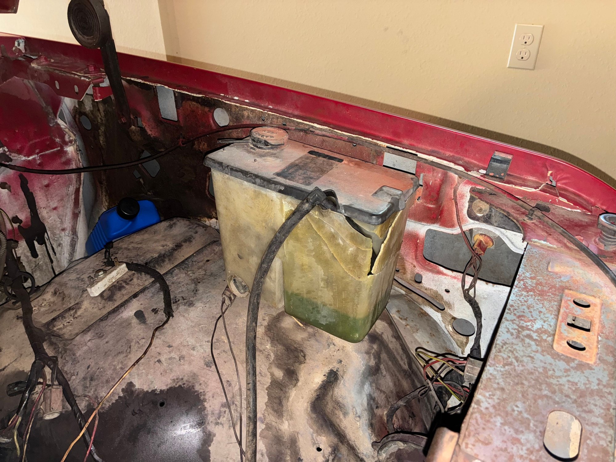

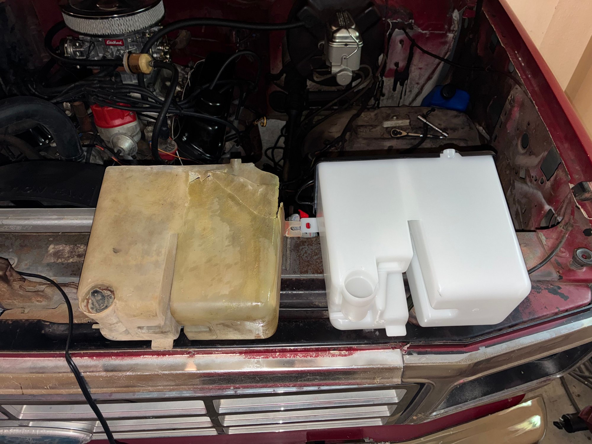

The overflow tank on my ‘84 has cracked with age so I started looking for a replacement. LMC Truck, Bronco Graveyard, and Dennis Carpenter all showed them to be out of stock. I figured I would have to throw the 87-96 model tank in, however I stumbled upon this
https://lmr.com/item/LRS-17618/mustang-dcr-windshield-washer-fluid-reservoir-79-85

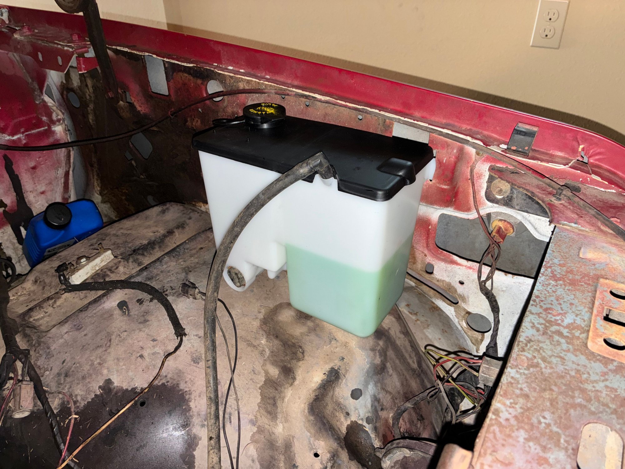

It’s a perfect fit. All mounting locations work with our trucks, only difference I saw in the tank is the windshield washer fluid side has a little cut out, which I assume is for clearance around something in the Mustang model. If you’re on a budget I’d honestly just go with the 87 + model as they’re half the price but if you want a stock replacement look this one is as good as it gets till the other companies get stock again.

As long as the hose goes inside and drops to the bottom of the tank, it won't matter. It just needs to stay submerged in coolant at all times so it can suck it out of the tank when the engine cools.
The early original tanks were more of a "catch tank" and did not have the hose submerged. The later tanks were more of a official reservoir tank. But as long as the older tank's hose is extended into the bottom of the tank and it has the proper recovery radiator cap, it will work as a recovery tank.

Yep that is what I have done to my tank, hose to the bottom and it dose pull coolant back into the radiator when it cools down.

My '84 has what I think you're calling the early style, just like the pictures in the first post (other than the broken corner). It has an opening in the top for the hose. The hose has an elbow, below which is a length of hose that reaches almost to the bottom. As far as I know, this hose was original from the factory. The hose is very thick-walled and almost rigid, not like the stuff you get from a roll at the parts store.
This arrangement definitely works as a recovery tank. I wonder if this was an intermediate "fix" before the factory switched to the newer style tank. The only opening is for the hose, maybe 5/8" or so. Unless using a tiny funnel, there's no way to top off the system at the tank.
