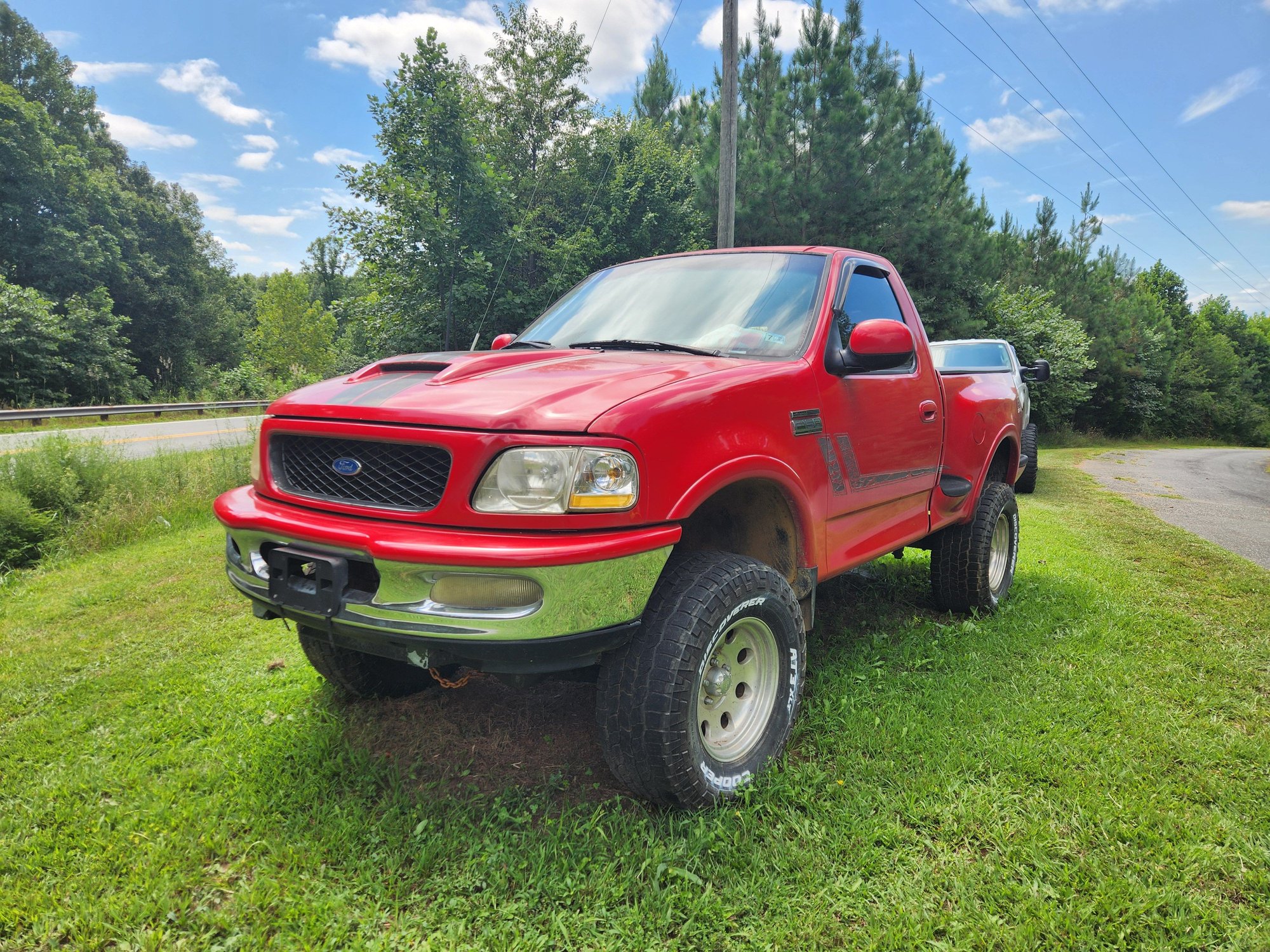

Hey guys...Just picked up a cute little 97 Stepside XLT with the 4.6. The body's in great shape, and should clean up nice.. but the motor is shot. Wondering can I install a 2v Mustang engine without too much wiring and computer headaches? Has anybody done this? What about a 3v Mustang engine?
