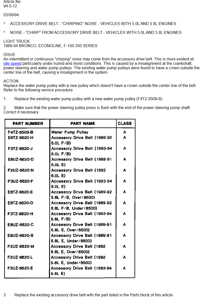

Originally Posted by NoelMc
Mine does that every now and then. I pour a little water on the belt while its running until it stops and it goes away for a while. I have been told deodorant works too but IDK.
ACCESSORY DRIVE BELT - EARLY WEAR OF FEAD TENSIONER PULLEY ON VEHICLES WITH 5.0L/5.8L ENGINES
LIGHT TRUCK:
1993-95 BRONCO, ECONOLINE, F-150-350 SERIES
ISSUE:
The FEAD tensioner pulley may show signs of early wear and/or erosion on some vehicles.
ACTION:
If a visual inspection determines an FEAD tensioner pulley has experienced extensive wear or erosion, replace the tensioner pulley assembly with a new steel pulley tensioner assembly (F5TZ-6B209-D). Refer to the appropriate Service Manual for service details.
Drive Belt Noise/Flutter
Drive belt chirp is a regularly occurring chirping noise that occurs due to pulley misalignment or excessive pulley runout. It can be a result of a damaged pulley or an improperly replaced pulley that was not properly aligned.
To correct, determine the area where the noise comes from. Then check each of the pulleys in that area with a straightedge to the crankshaft pulley (6312) and look for the accessory pulleys to be out of position in the fore/aft direction or at an angle to the straightedge.
Belt squeal is an intermittent noise that occurs when the drive belt slips on a pulley during certain conditions such as: engine start-up, rapid engine acceleration, or A/C clutch engagement.
Drive belt squeal can occur under the following conditions:
  1. If the A/C discharge pressure goes above 2895 kPa (420 psi). This can occur if:
    1. The A/C system is overcharged.
    1. The A/C condenser core airflow is blocked.
    1. The fan blade (8600) is not engaging fully at idle.
  1. If A/C OFF equalized pressure (the common discharge and suction pressure that occurs after several minutes) exceeds 965 kPa (140 psi), which is a rare occurrence at high ambient temperatures with a hot engine, turn A/C off for a few seconds and then back on after fan blade begins to cool A/C condenser core.
  1. If any of the accessories are damaged, or have a worn or damaged bearing or internal torsional resistance above normal for any reason. All of the accessories should be rotatable by hand in the unloaded condition. If any are not, the accessories should be inspected.
  1. If fluid gets on the drive belt. Fluids include power steering fluid, engine coolant, engine oil or air conditioning system lubricant.
    If fluid does get on the drive belt during service, the best policy is to clean the drive belt with soap and water and thoroughly rinse with clean water. The drive belt does not have to be replaced if no apparent damage has occurred.
  1. If drive belt is too long. A drive belt that is too long will allow the drive belt tensioner arm to go all the way to drive belt tensioner arm travel stop under certain load conditions, which will untension the drive belt. If the drive belt tensioner (6B209) is resting on the stop, replace the drive belt.
  1. If the drive belt tensioner is worn or damaged. The drive belt tensioner arm should rotate freely without binding.
    NOTE: Pulleys being replaced for suspected bearing wear should be evaluated for rough bearings. Bearing noise that continues or rapidly returns after a replacement pulley is installed is usually belt chirp rather than worn bearings. Bearings should rotate smoothly with a slight resistance due to the permanent lubrication.
    A chirping noise from the accessory drive belt that is more noticeable at idle than at higher speeds may be caused by a power steering pump pulley (3A733) that is out of alignment.
    The misaligned power steering pulley causes the accessory drive belt to chirp as the belt enters it on an angle on 4.9L engines, or after it leaves the power steering pump pulley, travels over the water pump pulley (8509) and enters into the crankshaft pulley (6312) on an angle on 5.0L and 5.8L engines. Verify that the chirping noise is coming from the entrance to one of these two pulleys by listening through a length of rubber hose or another stethoscope-like device.
    If the chirp has been isolated to one of these pulleys, then correct this condition by aligning the power steering pump pulley using the following service procedure.
    NOTE: Accessory drive belt chirp not corrected by this procedure may be caused by a damaged pulley or bent accessory shafts. Steady pulsation of the drive belt tensioner (6B209) indicates this condition. Observe each pulley in the system for runout.
    If your have a startup squeal, I highly recommend reducing blower fan and turning off AC on startup , this if severe can cause your belt to glaze and then always make noise
    If it still squeals, you may have whats known as belt PILLING. Thati s where the grooves of the pulleys are filling with belt material. After hours of cleaning my crank and ps pump and ac comp (replaced alt so diddnt bother there) I was able to reduce the startup squeal that would last seconds on my 4.9 even with no loads, it took a lot to clean the grooves of the pulleys since it beds in so tight.
    If you have rust or debris on pulleys, clean em up

There was an updated waterpump pulley that fixed belt squeal in trucks of your era
Look into that TSB for the waterpump pulley

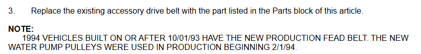

Good job Aurora
That means his 1995 should already have the updated (machined) pulley

Good job Aurora
might be a good idea to pull the pulley and check, they have a number stamped in them, although that probably is different (engineering vs service, right?) but should be close
The engine for all he knows is from another truck or maybe sourced parts at some point from another
