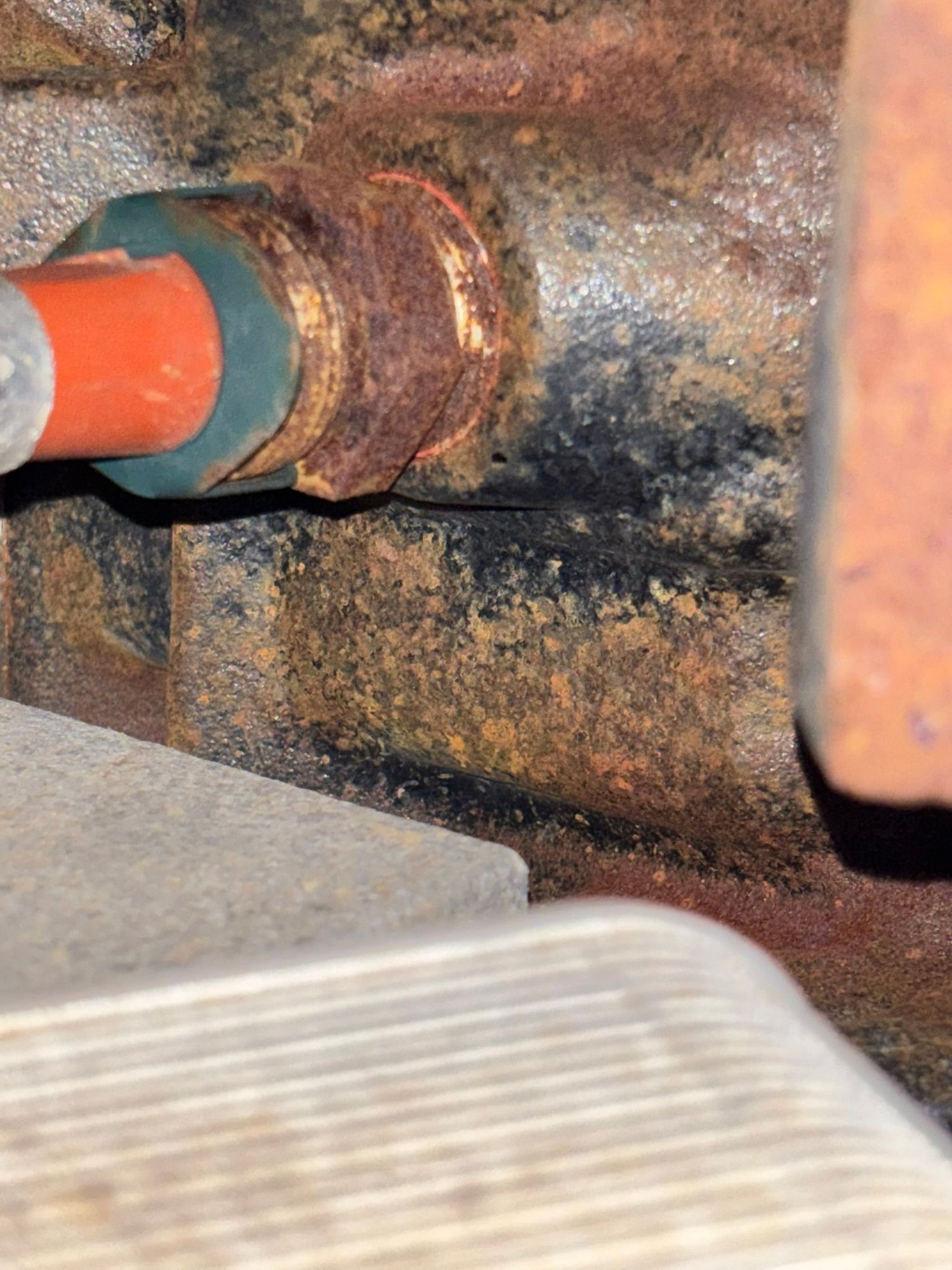

Having trouble confirming the correct part numbers and install location for a block heater. Mine is a 2022 F250 6.2 gas, the ones that show up under my vin say it’s for a 2019-23. And that’s all I can find. Also need info on where to install it in the block. Any assistance would be appreciated.

I have a 22 6.2 with a block heater. I will do my best to remember to get you a pic tomorrow of a factory install. I would not be surprised that the part numbers are the same across multiple years. If I forget please message me.

from underneath the truck it would be between the oil filter and transmission

Drivers side of the block between the oil cooler bracket and the bellhousing in a threaded hole. The wiring harness then goes forward along the drivers side frame rail and terminates behind and above the air scoop at the bottom of the radiator opening. I think a new harness will have the attachment points so that you can find the right holes and such for it. Let me know if you need more.
