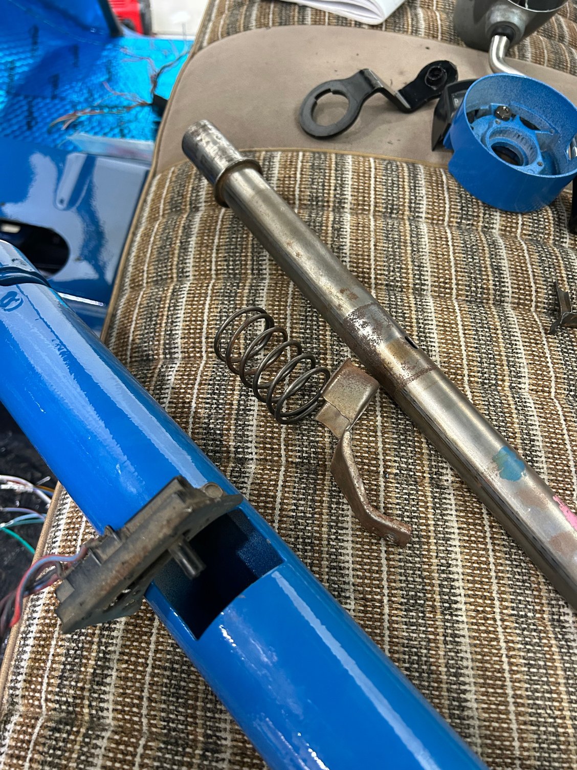

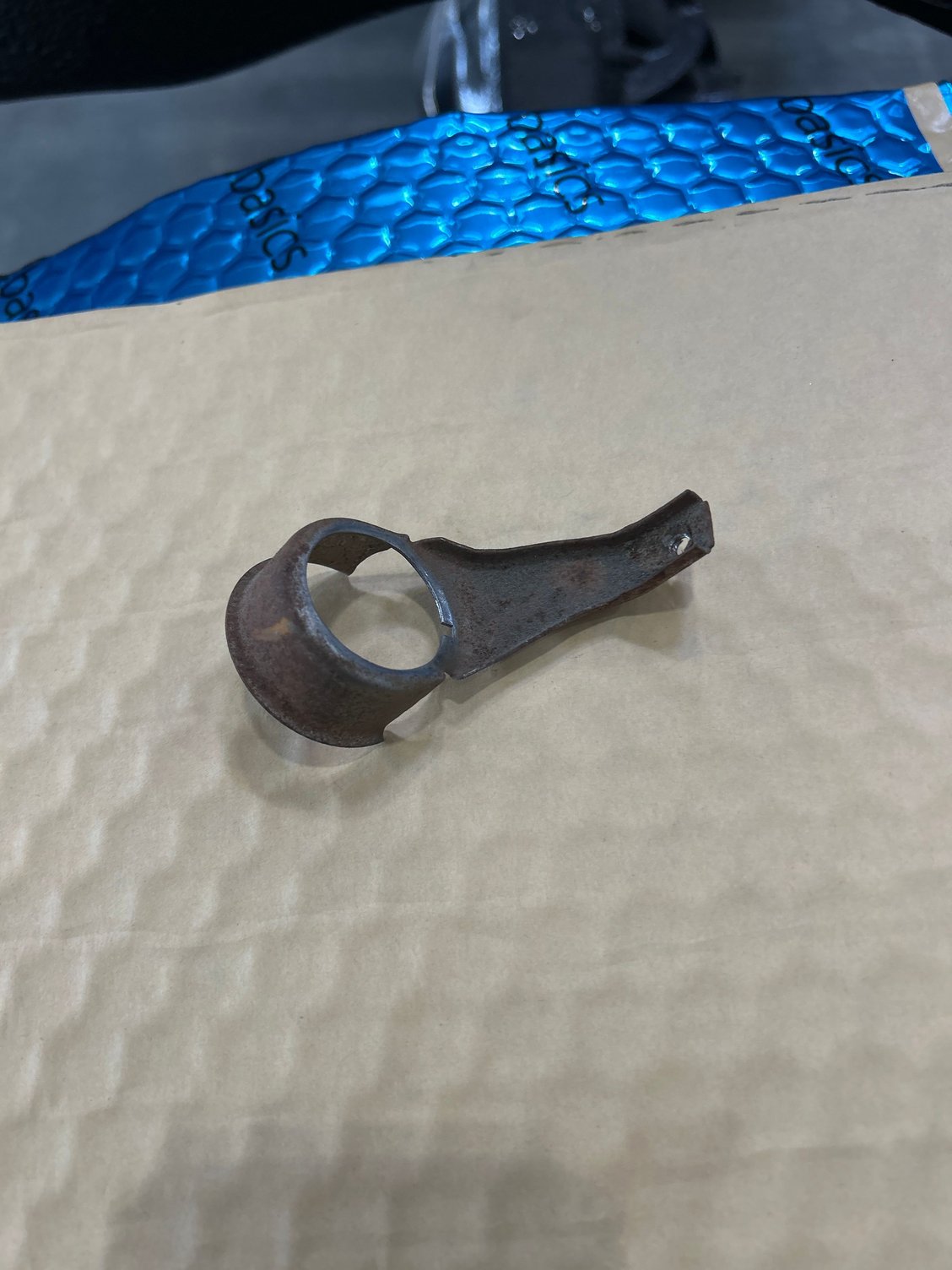

Well I did something dumb and took apart my steering column without taking photos. Seemed easy enough but it never is lol.
Ive got it all solved except this spring and it’s retainer (photo attached)
I’ve noticed the collar doesn’t seem to fit down the shaft which make it even more confusing.
help would be really appreciated as I’ve got everything else solved but this will cause some issues.
thanks

Well the lone piece in the pic is what goes behind the dash whne you installe the ignition switch.
All I got.
All I got.
All of this actually makes sense. Trying to get these damn square head bolts in are hard enough let alone under tension.... arggg thanks
