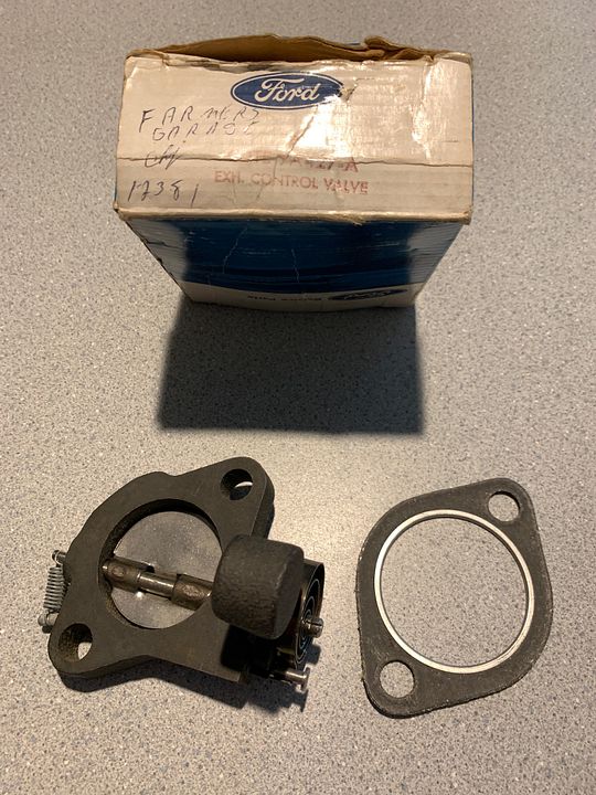

Yes, when they malfunctioned - often rusted shut - it was VERY common to remove the valve mechanism and reinstall the non-moving metal portion back into the system to act as a spacer. Brazing the holes should be fine.
I have an NOS valve and just pulled it and took a look. Both sides are completely flat. It came with one gasket as shown. I don't believe they used any donut.
C0TE-9A427-A - VALVE ASSY. - EXHAUST THERMOSTAT CONTROL
I believe the gasket is the following, but as always do your research.
C1SZ-9450-A - GASKET MANIFOLD
You can look on eBay for that number and get a visual. I don't have any of those yet as a separate part so can't confirm.
Soaking them and some heat are not bad ideas. But WD-40 is not what I'd use. I use a 50/50 mixture of ATF and Acetone - shake well before each use. It's been proven to work better than Kroil, PB Blaster or Liquid Wrench. WD-40 doesn't even make the short list. I disassembled my entire exhaust system from manifold bolts to tailpipe and didn't break any on a 1964 truck that's sat outside for years.

That is very clear, thank you for pulling your part from your extensive collection; always love your NOS part shots. Only one gasket is interesting and good to know both would be flat. Thanks once again.
