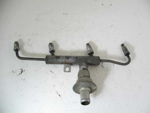

There are no thermactor, EGR and oxygen sensor connections on the manifold. The air injection connects to the back of the heads. .
Some of the early EFI engines got the rediculous air injection manifold system from earlier carbed versions, there were lines into each port of the exhaust manifold similar to what they did with the I6 motor,
My ‘87 did not have that and neither did the ‘89 so I would think that would also be the same for the OP’s ‘88 but I could be wrong.

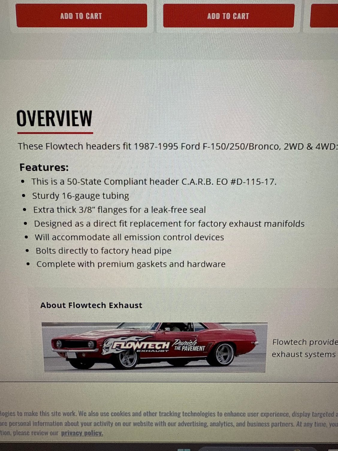

Are you in California? If so you know about the CARB exemption needed on aftermarket parts.
That's why I ended up saying go back to stock manifolds. They bolt up and no struggle with the smog test. Seems like the lowest cost most effective way to be back on the road quickly.

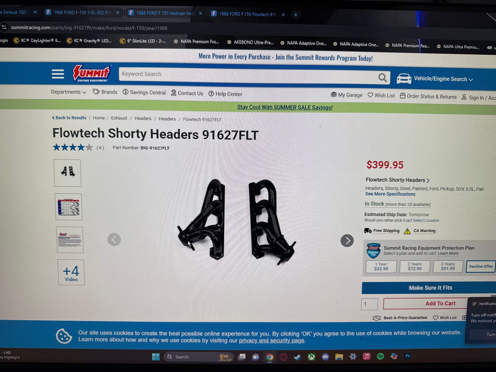

I am in CA. I heard about the CARB exemption. But I did see this has the CARB and EO #, so I should be good with smog? And since the EGR didn’t route how I thought it’ll just bolt in?
If these ones don’t work I’ll just go to stock. But it does run I’m not in a rush. I just want that tick gone.
