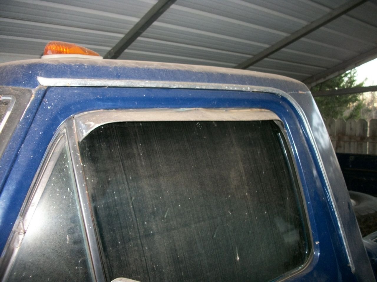

These were installed by the PO, and not very well on the blue truck. Maybe some of that new body panel adheasive would work?

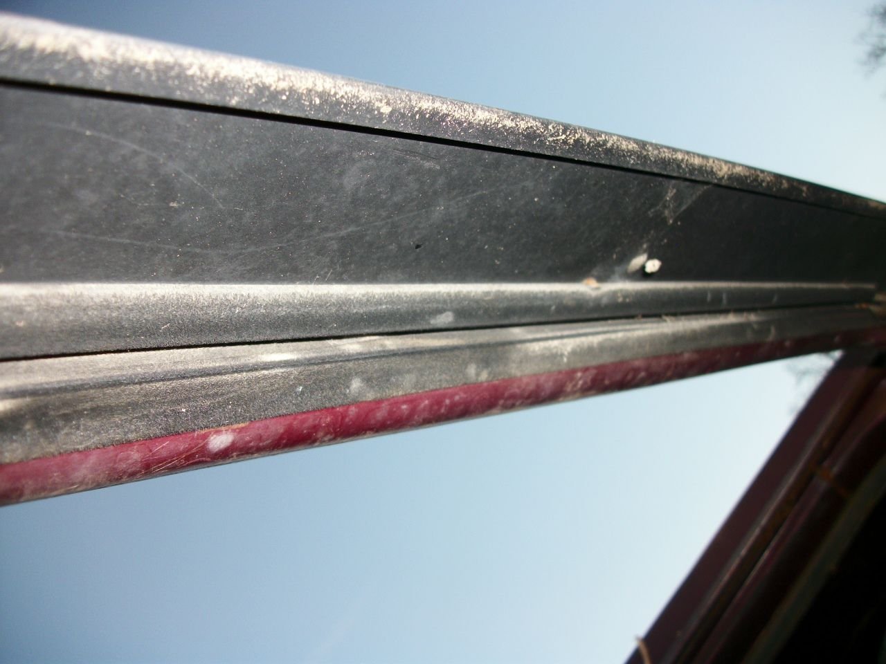

You can see where they did not have the shade seated, before that ran the screw tight. This is the middle one.
The PO of this one did a better job.
