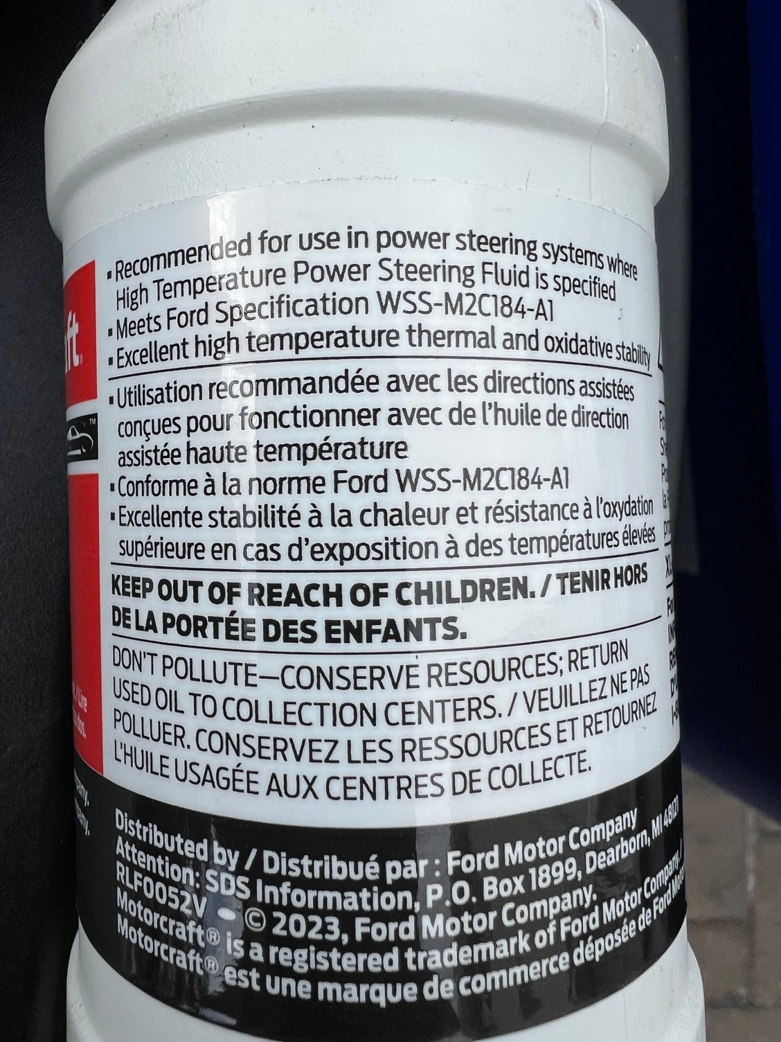

what are you using for fluid. My 2019 f-450 takes this stuff.

My 16 had Mercon LV from the factory and when I did my flush, just put Mercon LV put in.
If you want to do a flush, go to this post here where I described what I did with my F350 and there's also diagrams for the lines. I gotta assume your 14 F350 dually more than likely has to be the same.
