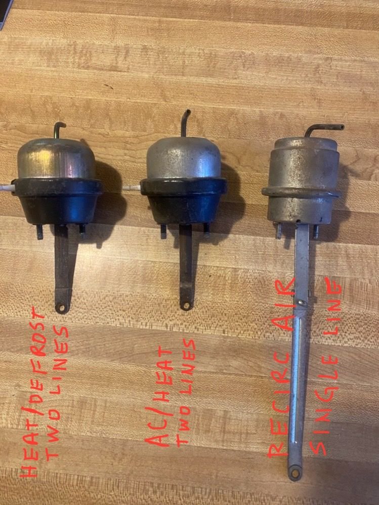

3. Are there differences in the mixing boxes and the vacuum motors? Do some of the early vs later boxes use vacuum motors with different number of vacuum lines to the vacuum motors (one versus two)?

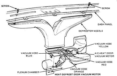

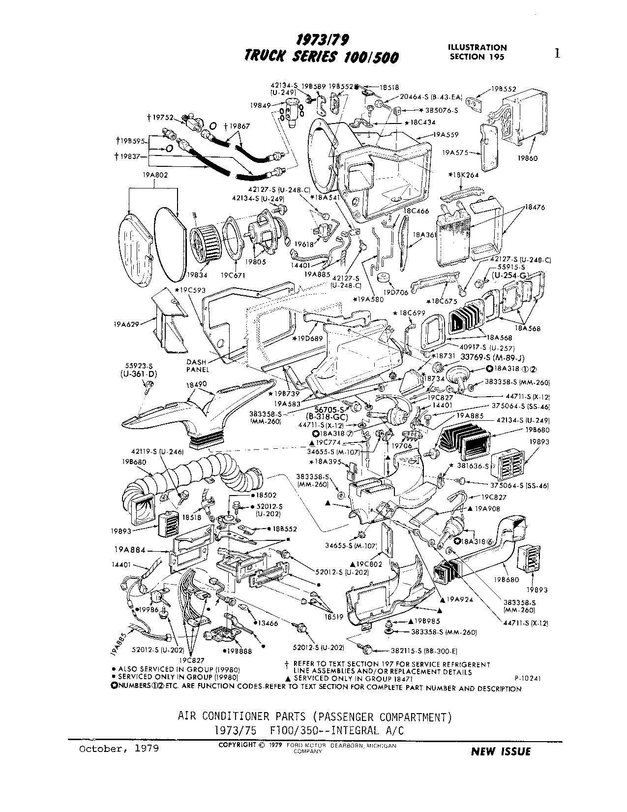

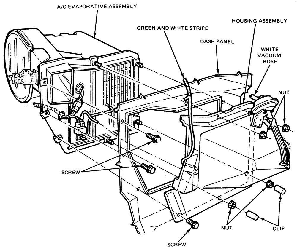

Side note: test the blower motor to be spinning in the correct direction. I hear that some times the 2 wires (orange/white?) can be backwards on repop motors and if you go color to color it MIGHT spin backwards. And once it is all in that is NOT the time to find that fact out.

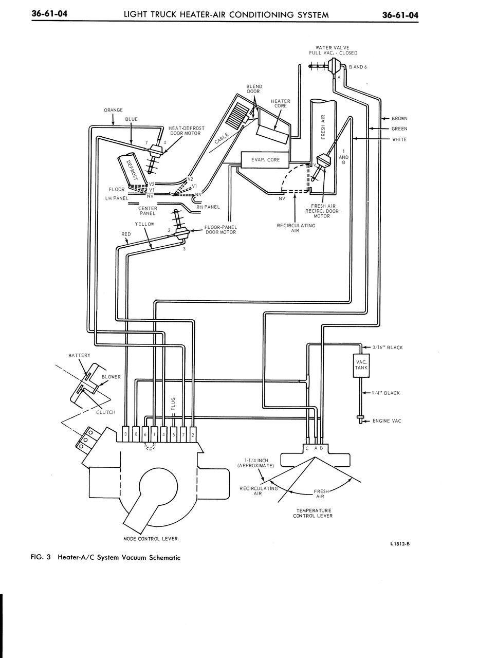

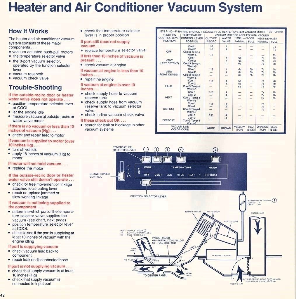

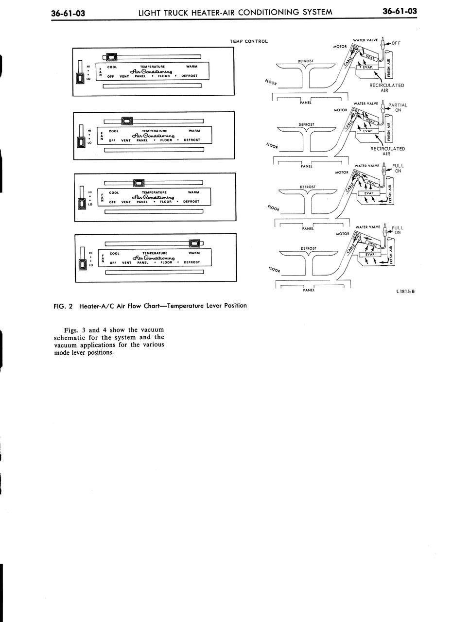

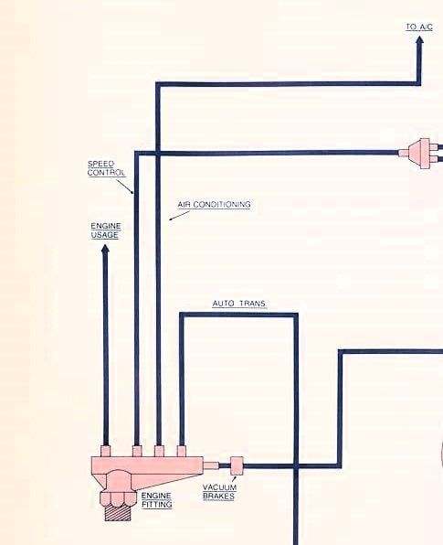

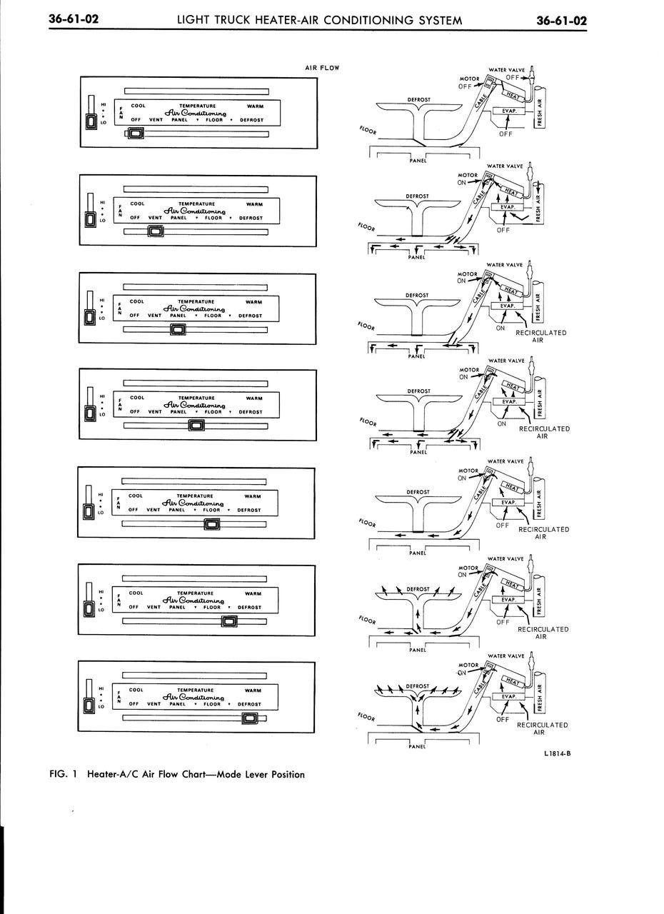

I just dug out my spare switches tonight. And I have all the vacume line stuff you asked about. So like the 3 and or 8 port stuff. I will try and contact (call you) you tomorrow afternoon. Here are some diagrams and info for ya. Too bad this link is dead. http://www.rowand.net/Shop/Cars/1979FordF100/AC.htm AWESOME info place with lots of a/c pics.
Parts place. https://cgfordparts.com/ac-heating-ventilation.html
Yes 78/79 Bronco, but pretty much the same as far as a/c parts and placement.
This below is thanks to DL burch.
