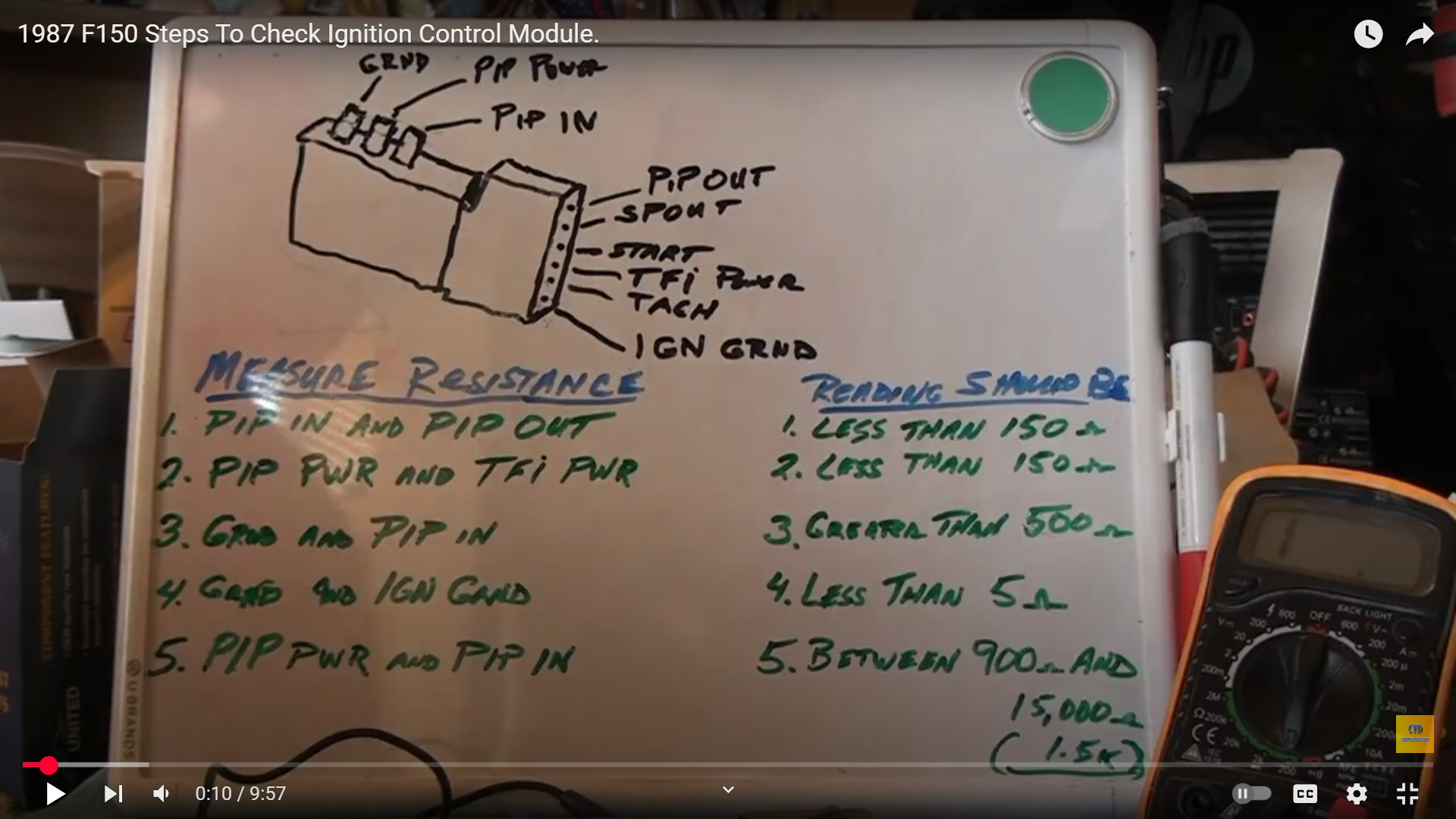

I stumbled onto this video:
It describes the testing procedure for a PS Ignition Control Module, the grey ones.
It includes this image:
Where can I find this information as it applies to the CCD ICM's (the black ones)?
ADVthanksANCE
-Jack (thinks he has a bad ICM in central Texas)

Thanks, SB.
Apparently, there really is no analog to the PS module test process, because the CCD versions do not have similar in and out connectors. Their architecture is completely different.
