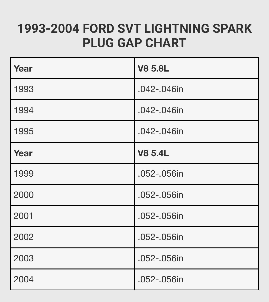

I found this in the LMR website. Gt40 heads where on lightnings. This is a ford lightning spark plug gap chart.  Does anyone object to this info?
I found this in the LMR website. Gt40 heads are on lightnings. This is a ford lightning spark plug gap chart. Does anyone object to this info?

are those plugs platinum ? If so, keep at it.43
if copper, .46

Specs say copper core with nickel tip. I will gap to .046.

because of copper and nickel, id use .46 too
The reason for .43 on my recommendation if platinum is platinum can hold heat worse, potentially causing predet, but ive only heard of that in boost scenarios
Copper has better heat transfer, nickel is presumably to prevent gap erosion, and iridium plugs use a tiny wire (which is different from the thick center platinums which is why they can handle more heat)

Bosch plugs in a FORD?
The gap goes with the ignition system
Back when GT40 heads were new, and being used from the factory in the AC Cobra and Shelbys, the gap was .032
With any electronic ignition with some BIG volts, you want to increase that plug gap to around 40-45 thou
