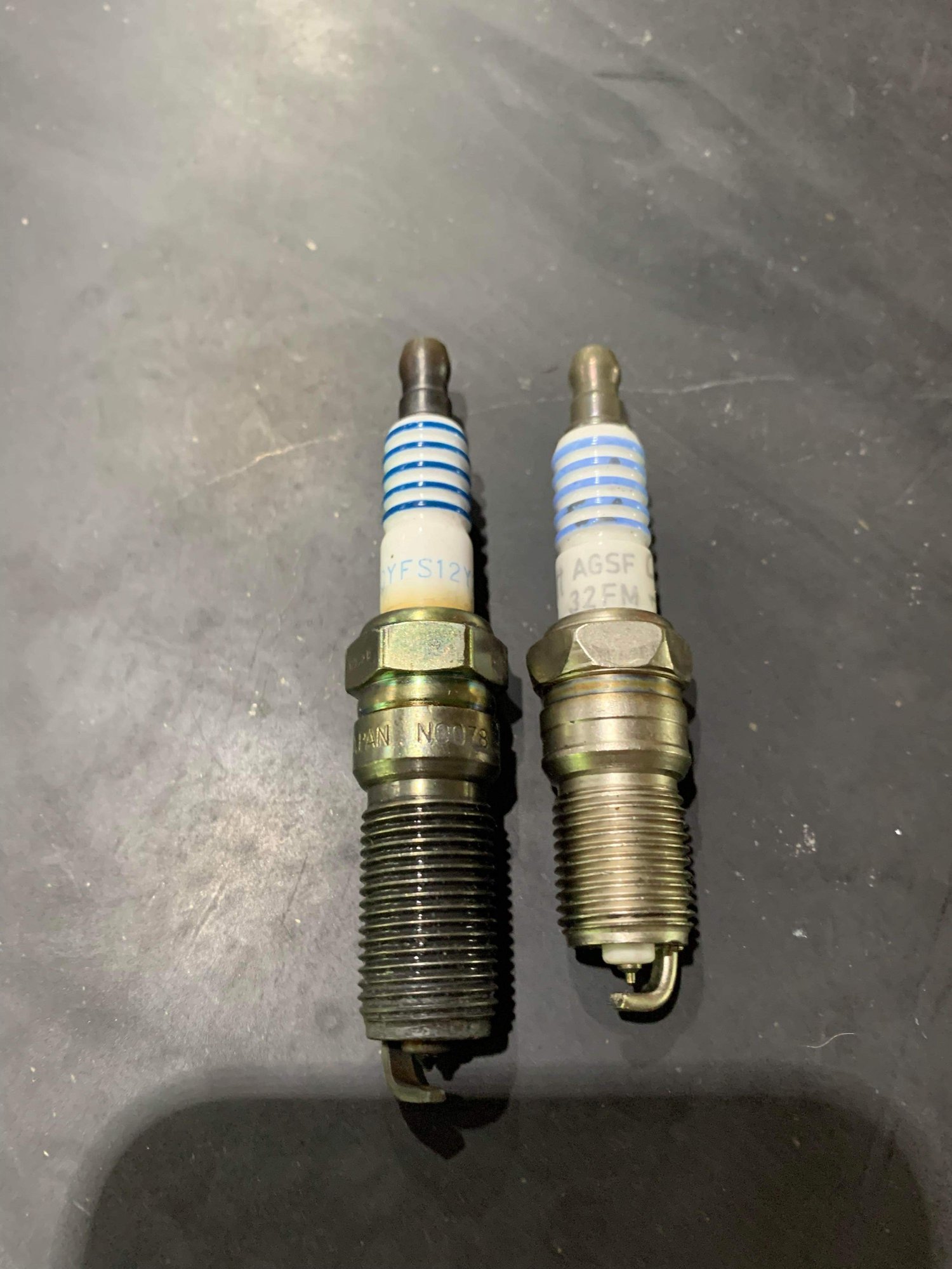

I ordered plugs and coil packs for my application off rock auto, they sent me SP432 and they are much shorter than the CYFS12Y2 I took out but if I go online it also recommends SP432 for Ecoboost. Will they work ?

See the difference, weird ?!

No one knows why such a short plug is called out for an e oboist compared to the one removed ?

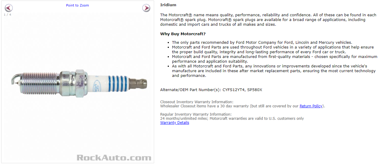

The long one is correct for the EcoBoost (at least for the 3.5L). When I picked the irridium Motorcraft plug for the 3.5L, it gave me an SP580. See below.

The Autozone website also shows the long Motorcraft SP580X spark plug for a 2016 3.5EB.

I saw online that was a plug for ecoboost so I ordered it, I sent them back and got some of the long stile. Never believe everything on the internet !!!
