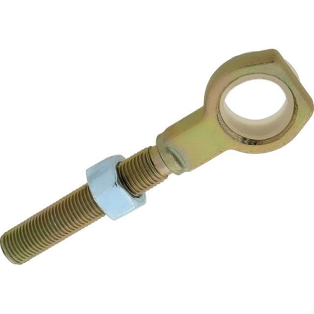

do you happen to have a picture of the right pedal rod? I’ll check what I got on mine .
I don’t have a pic of the pedal rod.
I grabbed this image off the webs, it is similar to what I used
Thank you! That’s what I thought I’ll need. I got this one on my break pedal now.
I saw the booster comes with a different end to it.
