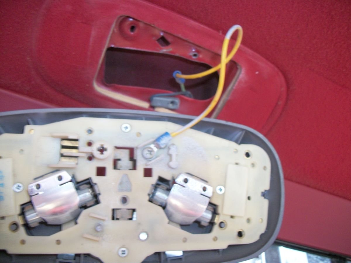

Hey everyone, I was trying to replace bulbs and fix my dome lights and when doing so I broke one of the metal pieces on the back that hold the map light bulb in. This is on a 1995 f350 cclb. None of the map lights work in the truck but the courtesy or dome lights come on when the door opens so trying to solve this mystery. Anywho if anyone can point me in the direction of find the metal pieces id appreciate it

Get on the bay and search: 1994 - 2007 Ford taurus dome light
Wire it up like this:

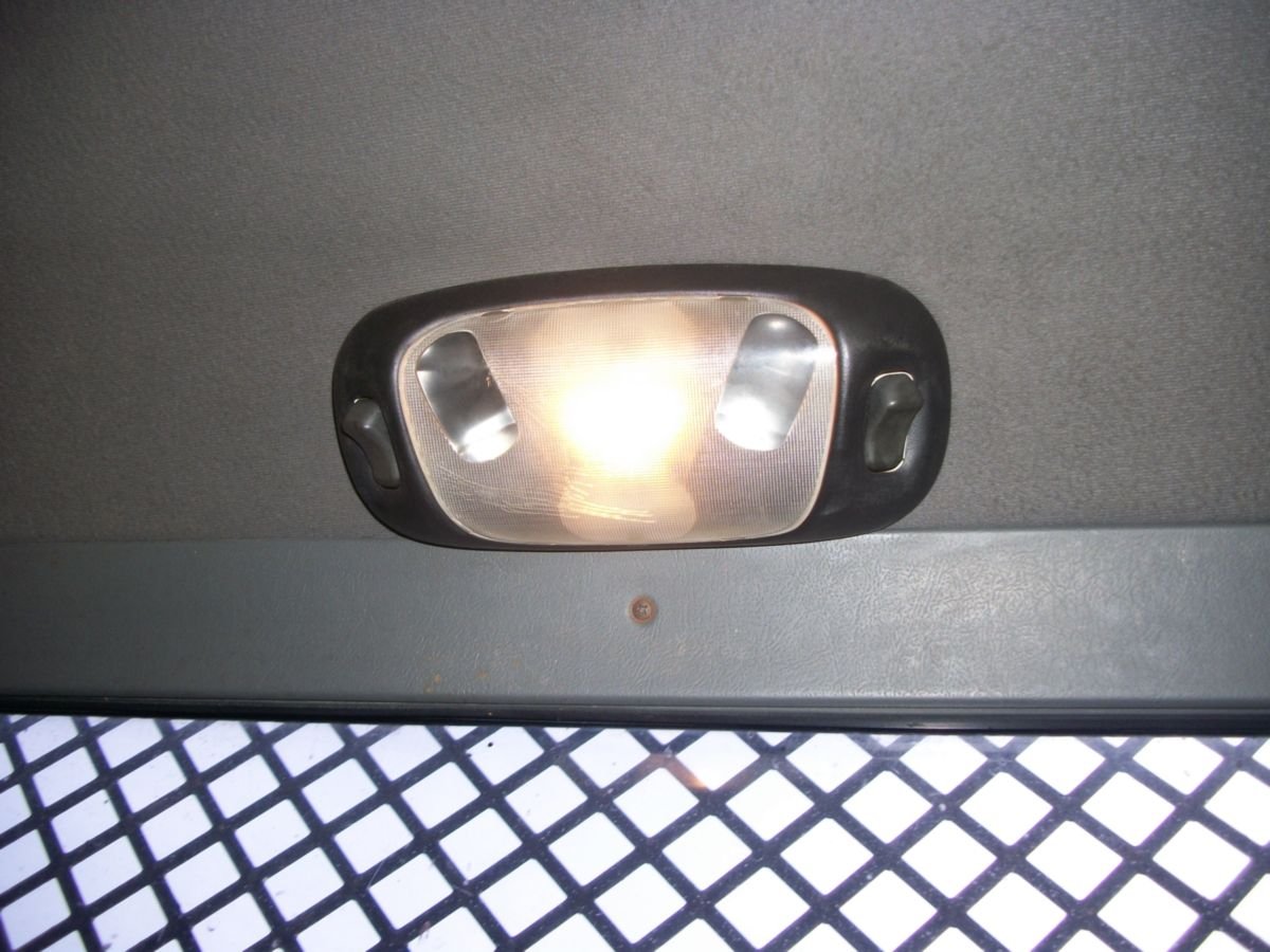

This is what it will look like mounted (old incandescent bulb still)
Get an LED light for it, and have light in the cab like you've never known before. Super bright and white. The two map lights wont point downwards, but you'll never need 'em anyway with the LED. You'll see.
Both my trucks got this upgrade years ago. Toss that factory thing as far as you can throw it (then go pick it up, so you don't littler.)

this is plug and play for the base model dome light (one 194 base bulb)
