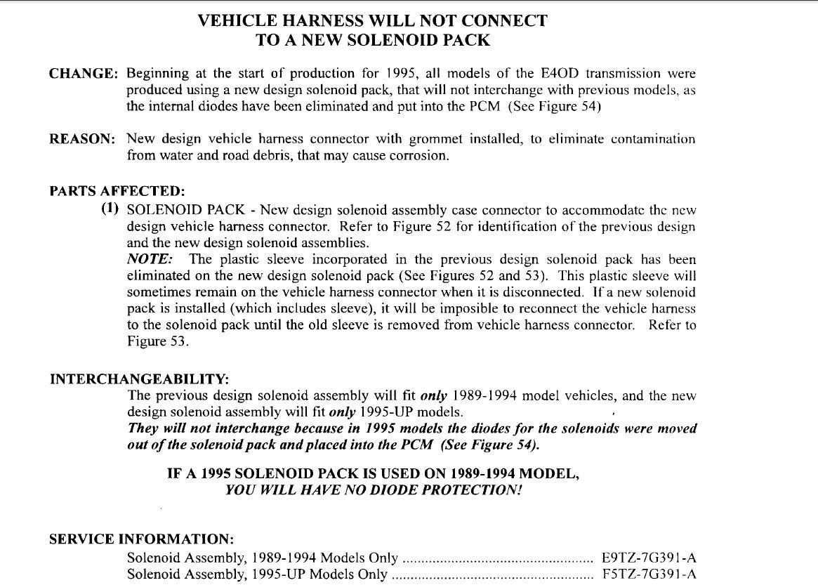

All this to say, I believe the transmission likely isn't original to the truck, and I'm not sure what year it's from. I replaced the TC, issues persisted, got it diagnosed and it does need rebuilt. It isn't building line pressure, so I'm told the internal seals are likely bad and a rebuild is necessary. If I go ahead with a rebuild, I'm concerned with the existing solenoid pack, as well as the parts kit I'll need to order for a rebuild. Is there any way to positively identify what year this trans is from? Are there any distinguishing markings that will tell? My concern is, if it's a 95+ solenoid pack with the original ECM, there would be no diodes for protection against spikes. I'm just not 100% sure how to proceed and looking for advice.

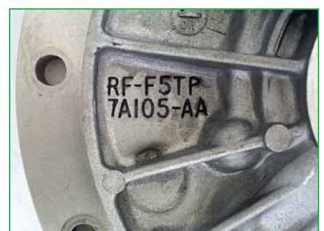

In 1995 the front pump is higher volume. With the converter removed, a 1995 pump casting # will start with "F5".
(they can be installed in '89-94 E4OD's too. I have them in both my '93's)
Solenoid packs can be changed between all E4OD's/4R100's when you need to keep the one for your truck to work correctly.
So during a reman, you would simply install a reman (or a good used) 1989-1994 solenoid pack.

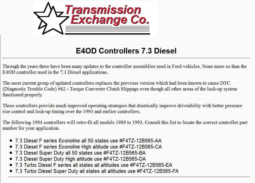

Gas vehicles MAF 1995 and newer EEC got the diodes in the computers, SD did not.
I believe you do not have EEC for engine in a 1992 diesel, but you do have EEC or Transmission Control Module(TCM) for the E4OD.
It is quite possible someone DID put 95 pack in, and not do anything else. The diodes are to "protect", does not necessarily mean the TCM will get fried, it could of course.
I am big in the electronics side and programming side of these EEC/TCMs, just picked up another 1997 EEC-IV SD E4OD and it does not have diodes in the computer. Maybe the SD versions didn't have the same issue as the MAF, i do not know.
Now, looking into your TCM, it has MANY diodes, much more than a gas EEC that controls the transmission.
Maybe your TCM has diode protection already built in and does not care which solenoid pack you put in.
I'd be interested to know what EEC/TCM you have that controls the transmission. Be something like DPC-100 GAB0, F_TF-126565-__

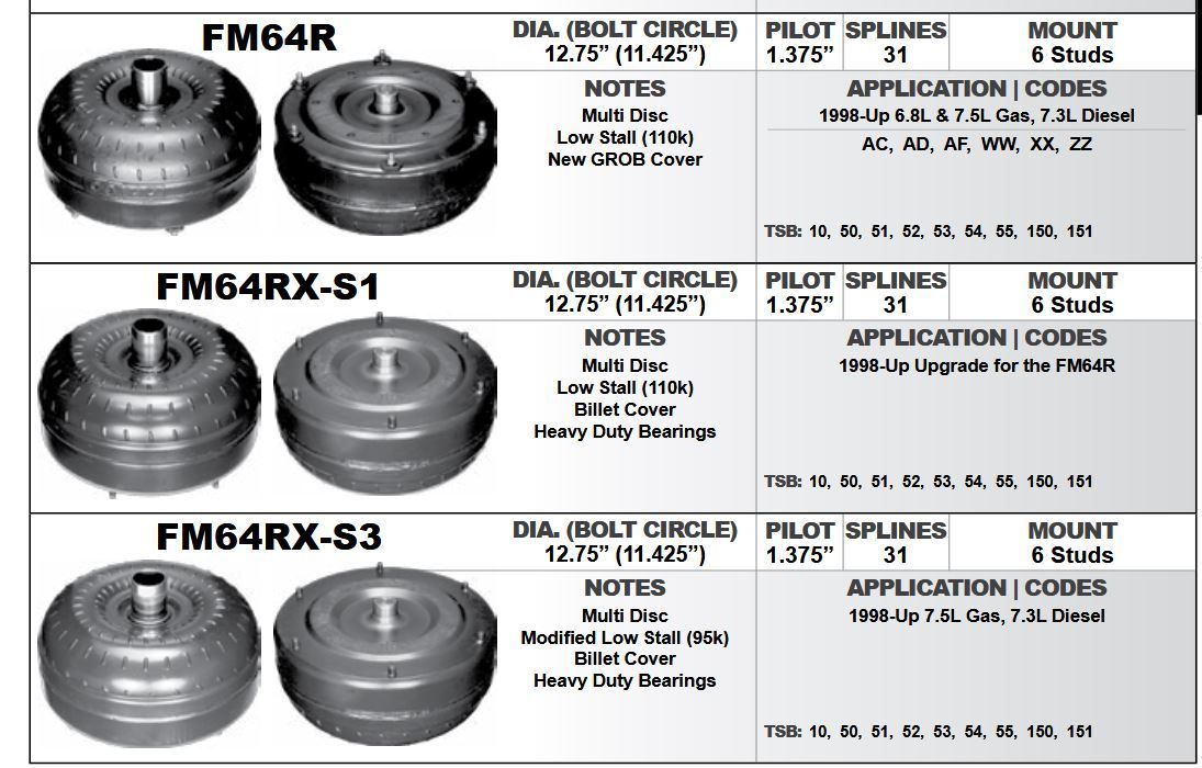

It was my understanding that all of the diesels had six mounting bolts, not four. Am I reading the image wrong, is my memory mistaken, are there really diesel torque converters with four mounting studs?
Old Sep 29, 2025 | 09:23 PM
FORDF250HDXLT's Avatar
FORDF250HDXLT
Joined: Jul 2006
Posts: 20,407
Likes: 878
From: Mi'kma'ki
The IDI diesel engines (like the original poster has) use 4 stud converters. The 6 stud was introduced during the 7.3l powerstroke.
