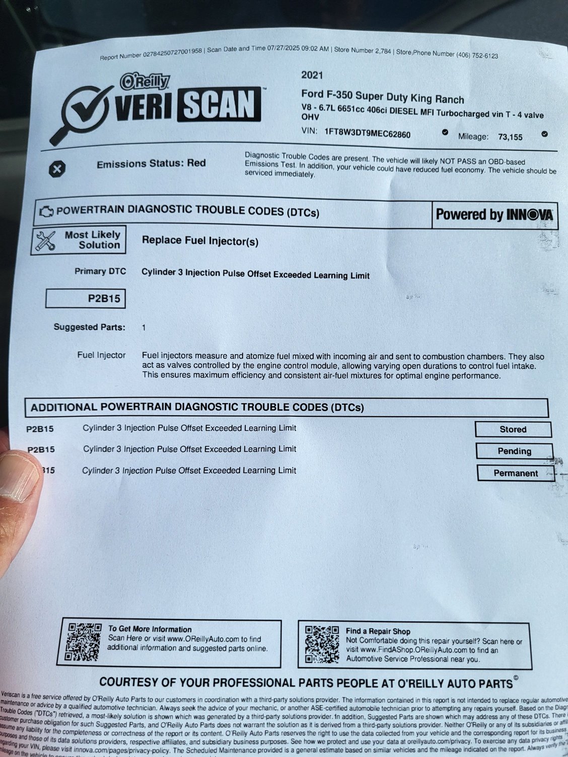

We were ready to head out to WA state with our 5th wheel to visit our 1st grandchild born 10.days ago and the check engine light was on. Scanned at O'Reilly's and this was the result. Dropped it off at the Ford Dealership nearby. Hopefully theyll get to it tomorrow.
Anyone had this issue? If so, did it turn out to be a bad sensor or bad injector?

Found this.
https://static.nhtsa.gov/odi/tsbs/20...33588-0001.pdf

Update:
Dealer said they have the software update to correct th MIL pulse sensor fault. They should have it updated in a couple days.
Apparently a common problem they've seen before.
