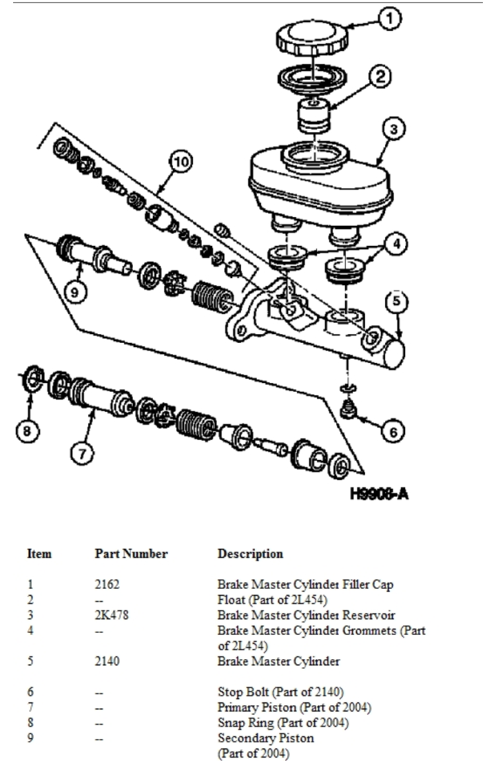

When you say you replaced a metal tube, do you mean the one that the engine coolant temperature sensor is threaded into? That area and the thermostat housing is a likely place for leaks, along with coolant hose band clamps that need some tightening.
I don't know if a '95 has the same master cylinder as an '88, but my '88 was leaking at the piston stop screw labeled number 6 in this drawing.
It's a slotted head screw, so I slowly tightened it, maybe 1/8 turn a day, for several days, and it stopped leaking.

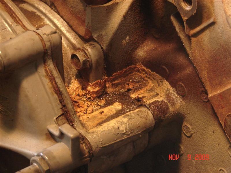

Here's my observation of the "loosing coolant, stinks, no puddles/drips" that has been confirmed as near universal for 5.8s/5.0s:
The timing cover passage leaks, cooks off.

you could try snugging up the nuts/bolts, in @Scndsin picture, mine had/has same leak now, 5yrs later, when I did water pump. and 3 studs broke off.
my truck had this same leak when I bought it. Replaced the water pump and gasket {thank the Lord no bolts broke on me} and has been dry ever since.
