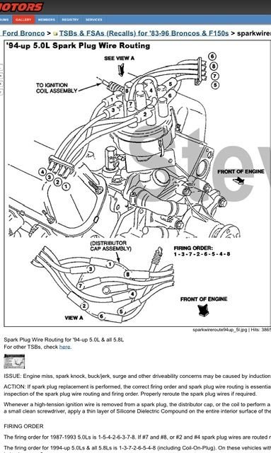

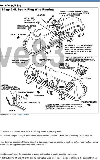

This is what you should be doing…

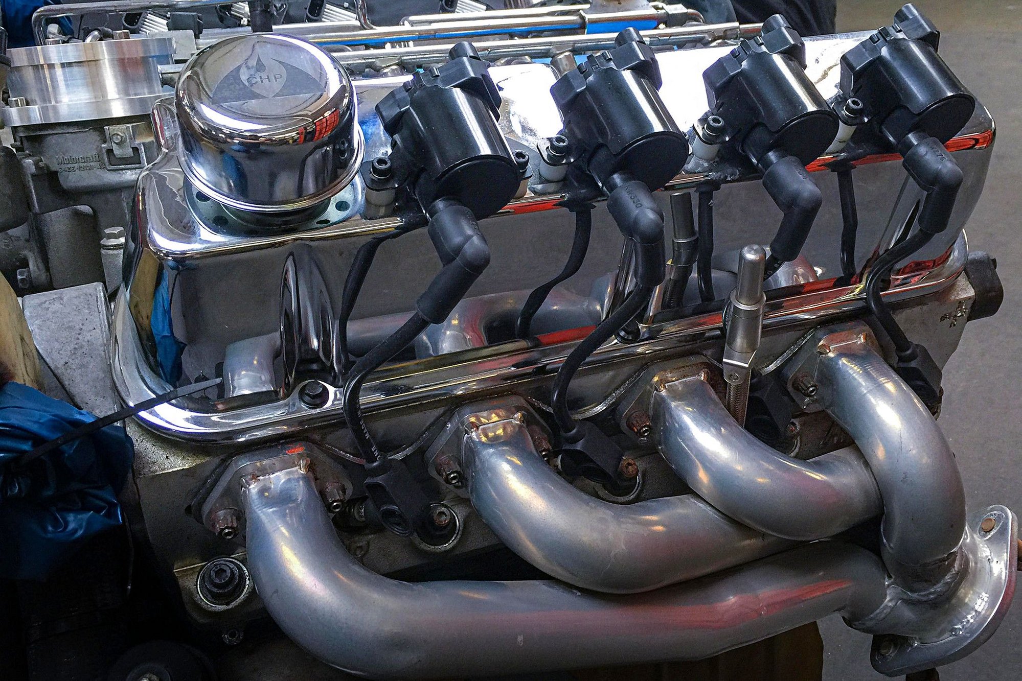

Old Jul 24, 2025 | 04:27 PM
wwhite's Avatar
wwhite
Joined: Aug 2014
Posts: 3,556
Likes: 850
According to you there will still be spark plug wires and now you will also have eight coils. When you’re done it will look similar to an LS, correct?
Correct, most use the LS coils for the swap.
Old Jul 24, 2025 | 04:37 PM
wwhite's Avatar
wwhite
Joined: Aug 2014
Posts: 3,556
Likes: 850
Originally Posted by Nmaykdm
send pictures. I’d like to see this please
I'm sure you can google ford 351/302 coil on plug yourself.
This isn't mine, but very similar, mine are mounted on the side of the valve cover, not the top.
https://www.motortrend.com/uploads/f/197463449.jpg
