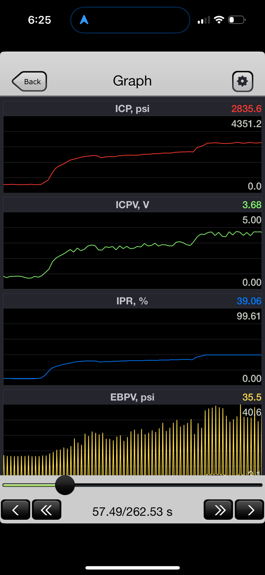

ForScan Graph EBPV parameters
Does anyone have a screenshot of EBPV graph from ForScan. I’m curious if my EBPV PSI graph is normal. I would think the valve is either opened or closed, but according to my ForScan WOT EBPV, PSI fluctuates between 35 and 3 indicating the valve is opening and closing.
EBP sensor was completely clogged, and the tube was partially. I replaced the sensor with new a part from Ford and cleaned the tube.
Any insight would be helpful.
EBPV is the last row.
I think I’m looking at voltage from the sensor with this particular graph. EPB_A is what I need for PSI. EBPV fluctuating between 3.3 and 0. So I guess the question is, is this normal? Is it a like pulse rather than a constant signal?
