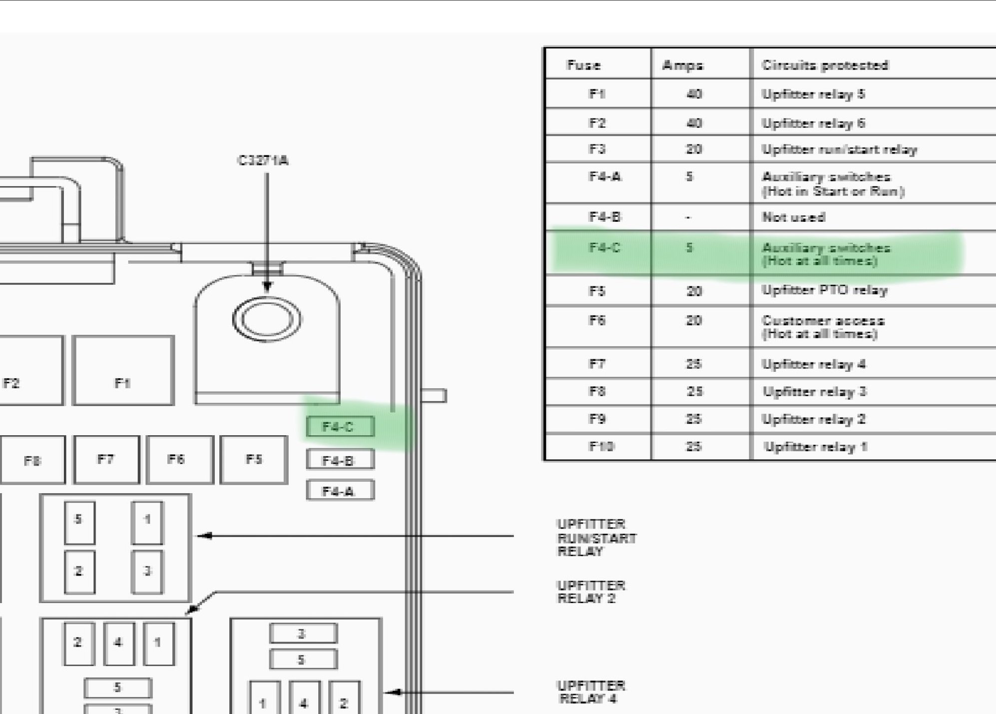

I have a strong dislike to the DRLs, but would have considered enabling them if the upfitter switch power supplies was always hot, so that I could automatically have the grill marker lights on when running. Like the upfitter switch solution a lot better, as I can leave them on all the time (or manually turn them off for special ops).
Got my lights but haven't had a chance to install them yet.
https://api-prd.fordpro.com/pro/bbas...355e6988c22f9f

From: SE Vermont, South Jersey
I hadn't gotten that level of detail yet. It was my understanding that user mods were required to provide full time power. But I will make sure to avoid F4-C.
Thanks!

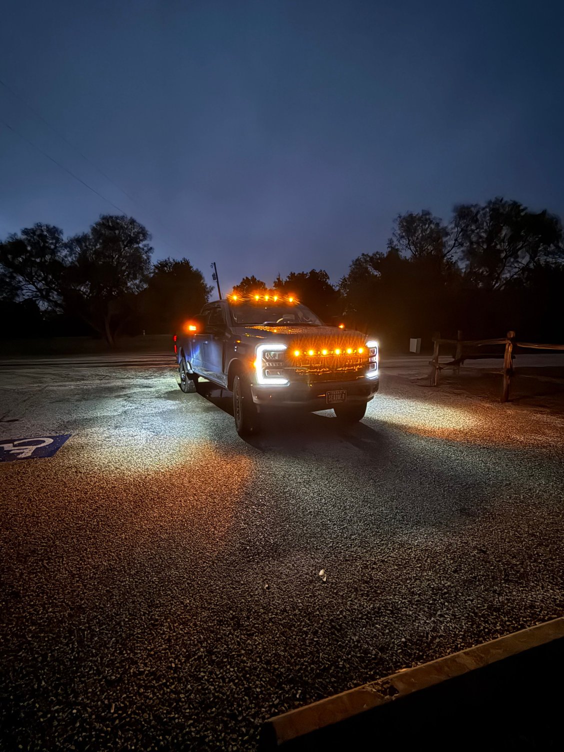

Old Sep 5, 2025 | 03:47 PM
srkr's Avatar
srkr
Joined: Jul 2008
Posts: 2,787
Likes: 658
Took this pic last weekend.
