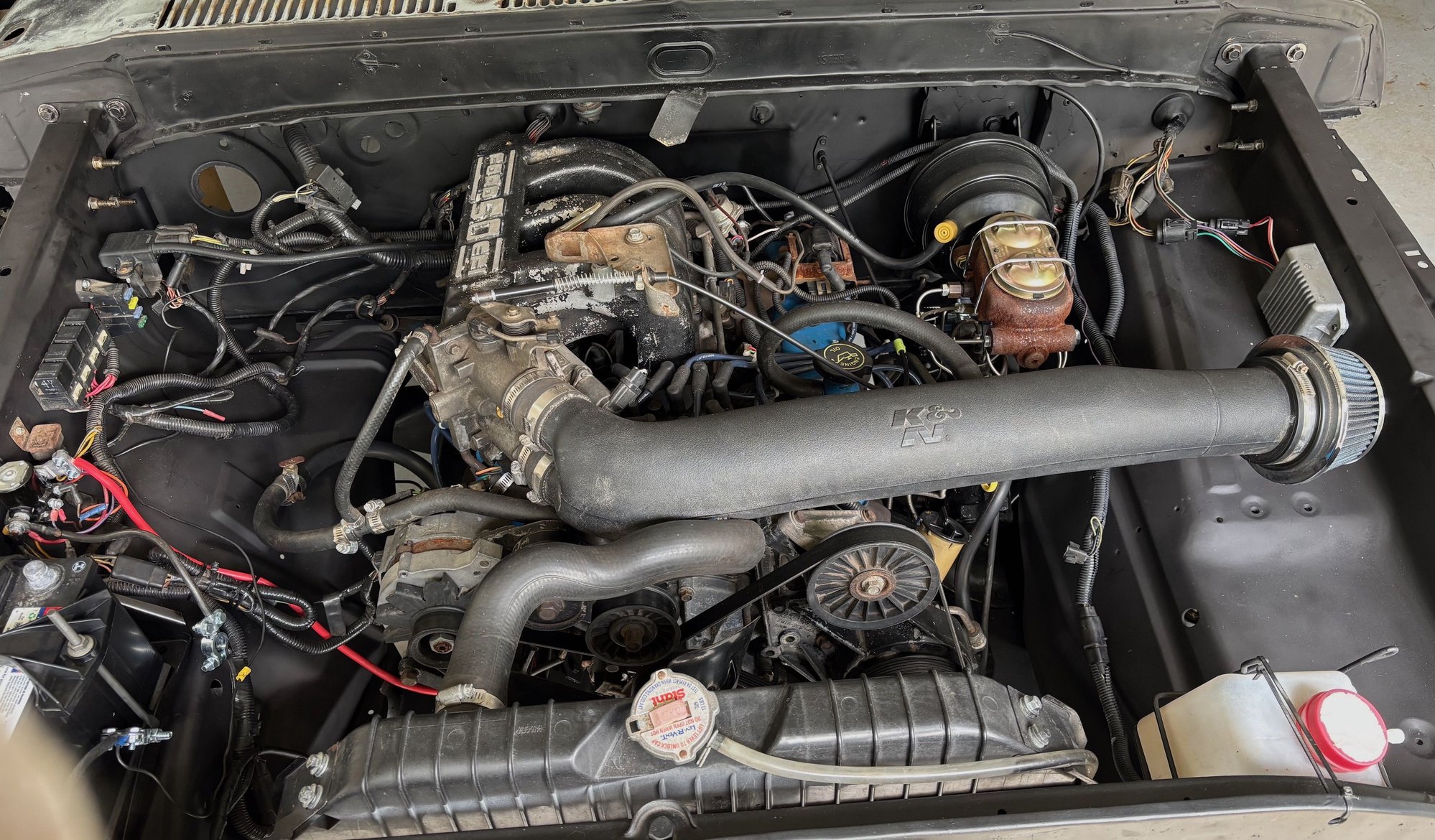

I am having to drop in a remanufactured long block to replace my current engine. The engine is a 302 EFI 5.0 out of a 1986 f150. The truck is a 1975 f100. While it's out I thought I would add some aftermarket headers. Any recommendations on some that will improve flow and still fit? I know this f100 has a narrower frame than the 1986 F150.

Just my opinion, but unless you're doing a number of performance mods I wouldn't bother with headers. For the RPM these trucks will see, especially on a stock or mildly modified engine, they're not worth the headache of leaks, rusting through and fitment.
For a stock or mostly stock engines exhaust manifolds are just fine and much easier to work with.

If you already have the proper exhaust manifolds and your exhaust tubing is still in good shape, I would just use what you have. These trucks rarely see even 5000 RPM, more often they're in the 2500-3500 RPM range where velocity is far more important than overall flow. If you have too big of ports they can reduce velocity at lower RPM. This was a problem for example on the 351C engines paired with 4v heads. Below 3000 RPM air velocity was way down due to massive port sizes and the engines didn't run very well on the street. Get them on the track running above 5000 RPM and those heads performed very well.
For a stock 302, exhaust manifolds into some 2.25" dual exhaust, your choice of chamber muffler(s) or glass pack(s) would be sufficient. If doing 2 into 1, you might bump to 2.5" or maybe 3" pipe post merge.

Everything looks to be in decent shape, but when it's out I will know for sure. It has dual straight pipes and all the tubing is like new. I hope I can re-use everything. I appreciate the sane advice as there are plenty of other needs for this truck when I put it back together.

Headers will help torque across the board vs a manifold and with a long tube style particularly at low RPM. A good quality header with a thick flange installed using high temp RTV and no gaskets will not have troubles with leaks.

Do you have the motor doner truck? Are you going to keep it EFI? If you are you are going to, have fun getting the 75 and the 86 to wire up and play good together. Electrnocialy and fuel, gauges, and some of there items can cause you some headache.
You are going to need ALOT of the 86 engine compartment wiring, main computer, or PCM, put 02 sensors in your exhaust. Address the fuel return line back to the 75 tank. Add as seperate elec fuel pump or get the 86 tank and reuse the EFI tank and sending unit? Seaking of that it is a 302 it is is stock, just go with exhaust manifolds.

I’m just replacing what’s in it. Previous owner re-powered it with the 1986 efi engine. I’m just throwing a long block in. I will re-use the manifolds and everything else that looks ok. The plus side is I can clean up and paint the engine while it's out.

I have a 76 Bronco crawler with sort of the same set up, and it is a vacume line/lot of other connections/wiring nightmare. I think they drank heavily when they did the swap. Stock output motor gets along just fine with exhaust manifolds.
