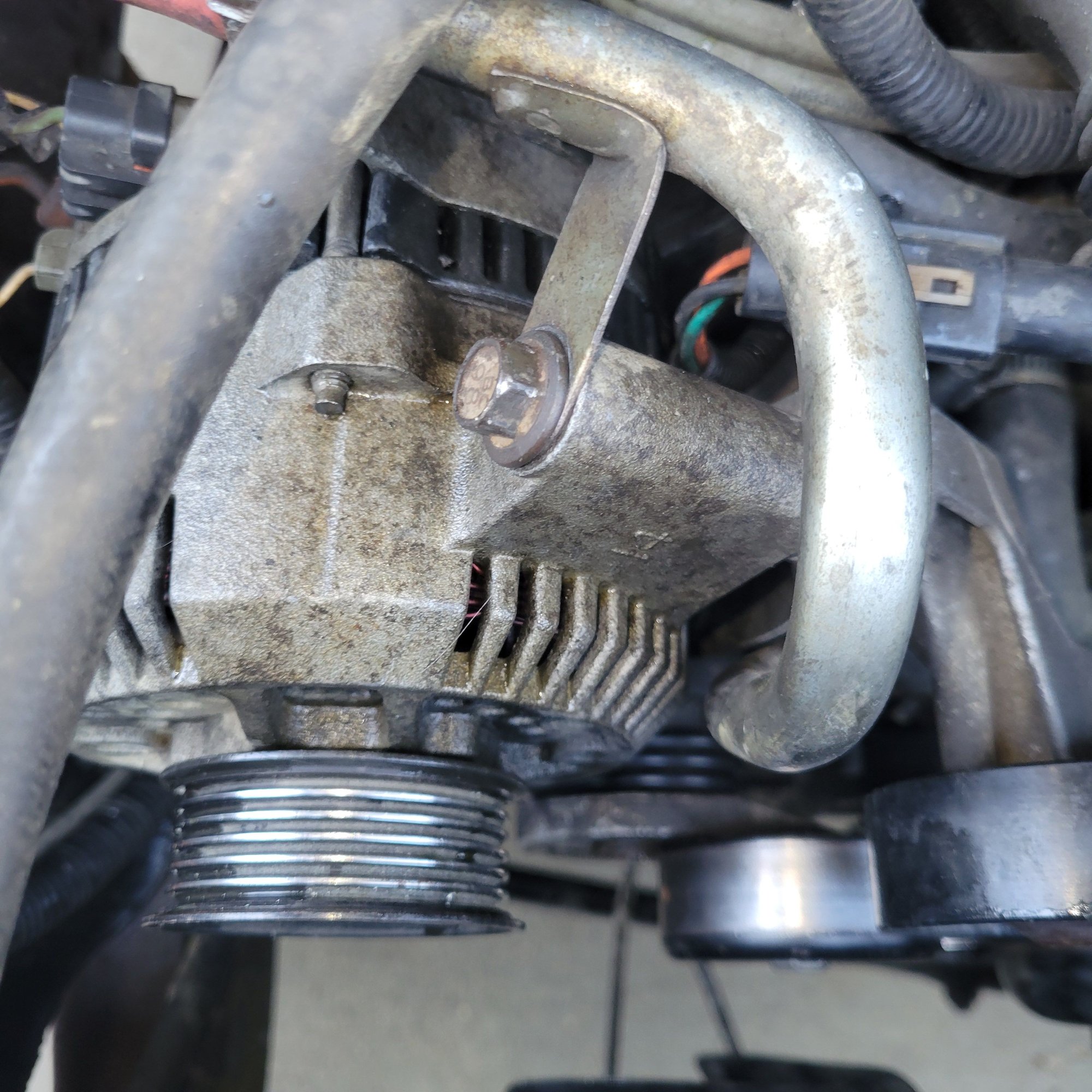

Originally Posted by wwhite
Is this a crack in your bracket? (circled in green)
I felt it, hard to say what it is. Here's another angle. I'll keep it on a list of things to check as I pull the airpump.

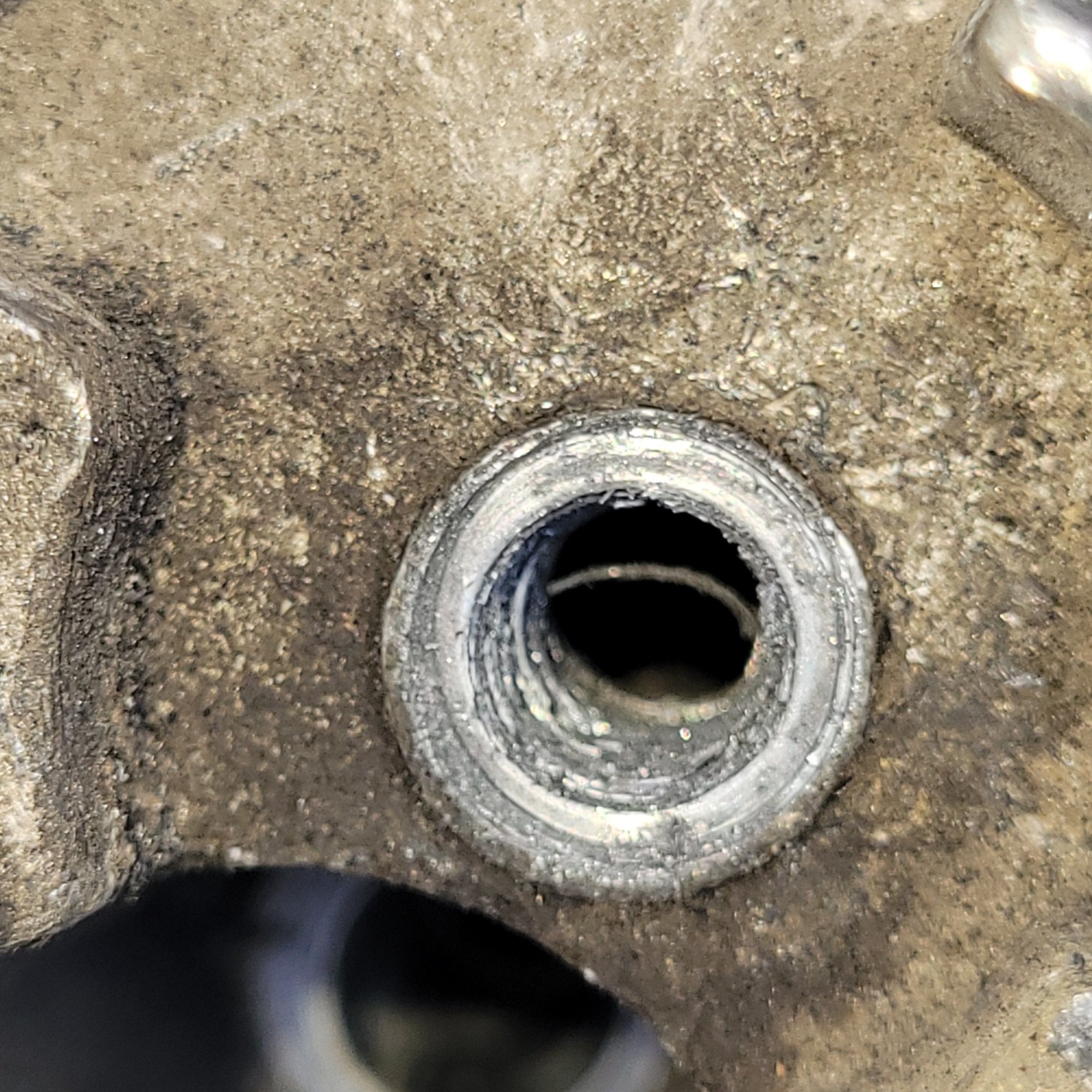

We have an ANSWER!
It is back together and running well.
It was the bracket the tensioner & alternator attach too. The threads for the tension were stripped. How it held on as long as it did is wild.
We used a replacement bracket from my old 94. The swap was straight forward and went well.
A word of caution, beware if you buy a truck from a farmer. Some of their 'repairs' are definitely not found in the repair manual.
Thanks again for all the helpful input!
This is rhe old one, check out those threads. Someone had to have crossthreaded years ago.
This is the old one, check out those threads. Someone had to have crossthreaded years ago.
