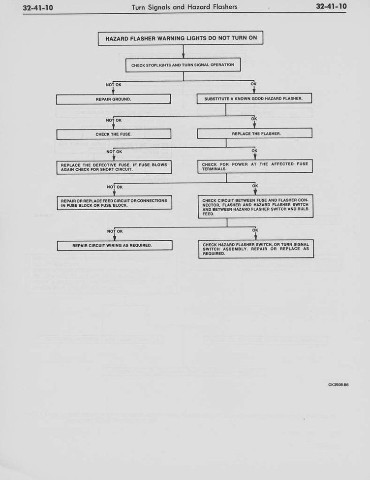

Man this is what I need
I will let you know how it turns out
Thanks alot
