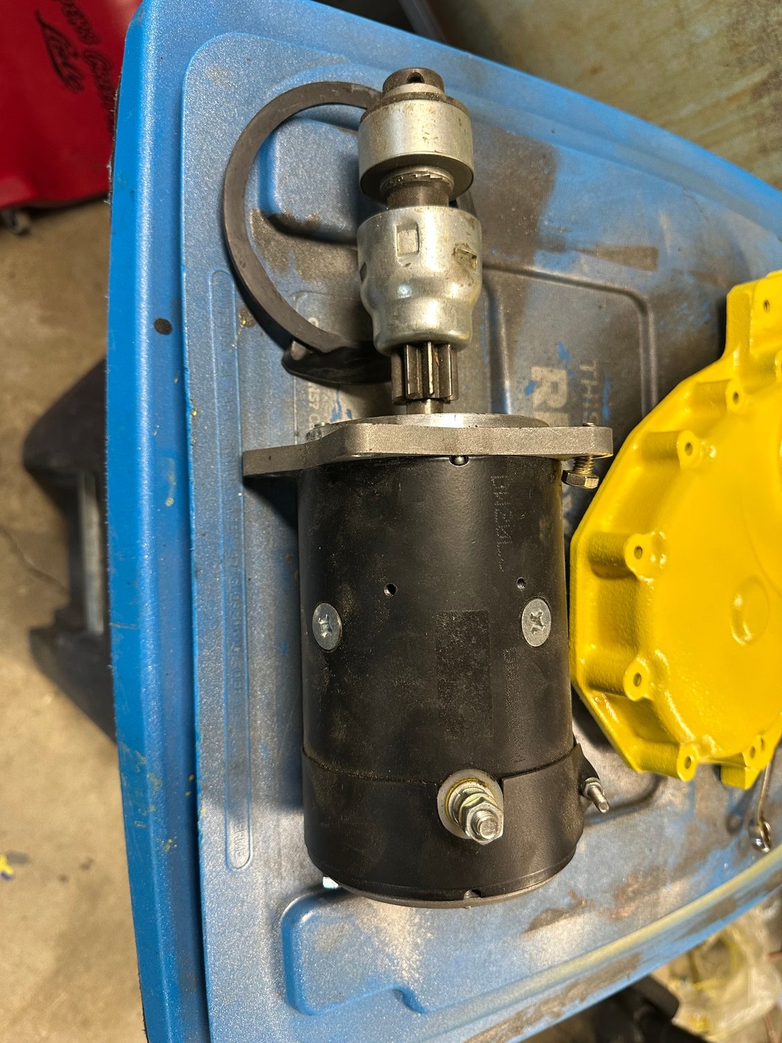

When I was trying to get the gear to reset on the bench by spinning it up it never got going fast enough to reset the gear. I suppose it's possible I have a 12v starter?
Video attached.
This is the starter I have.

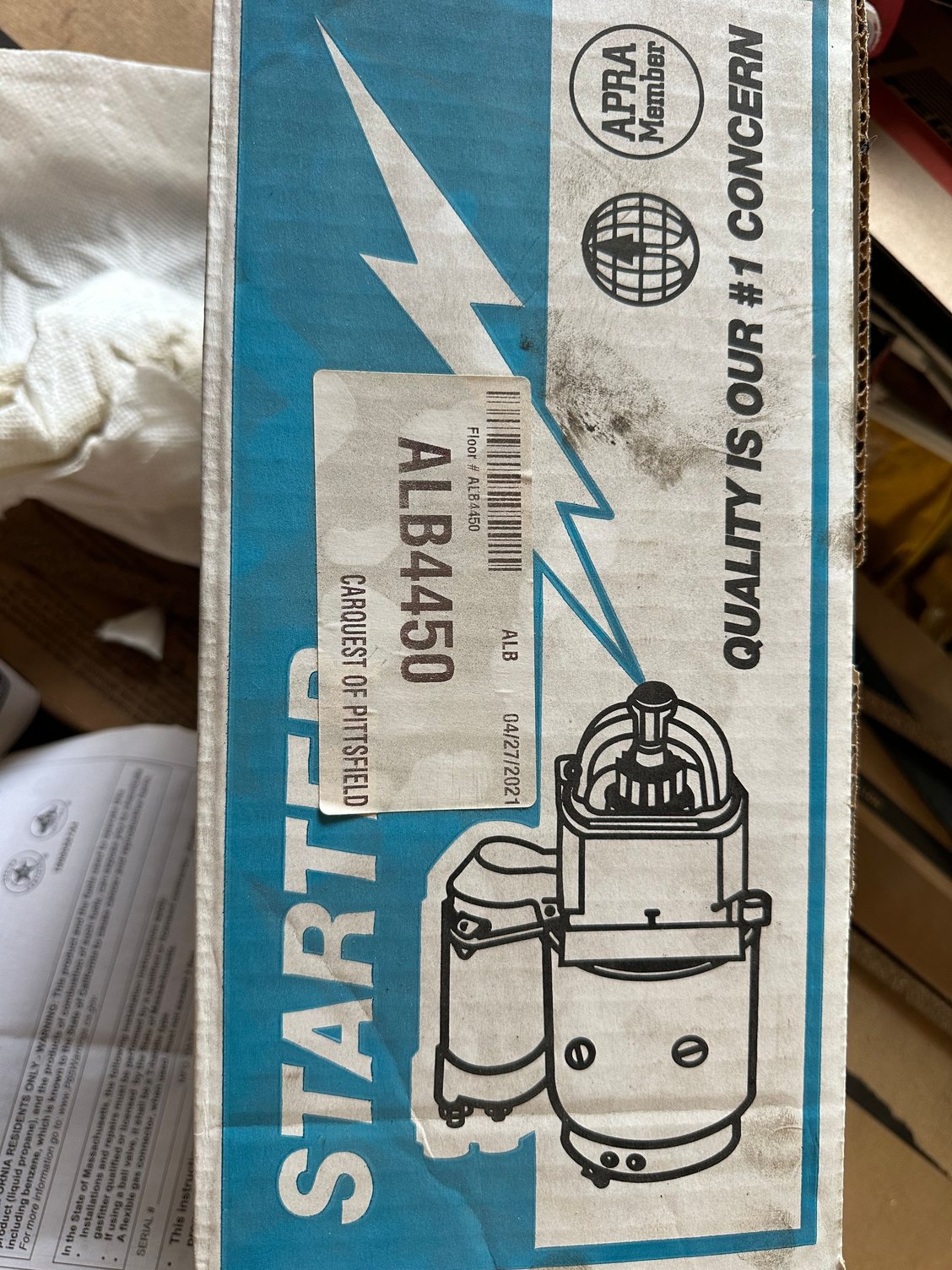

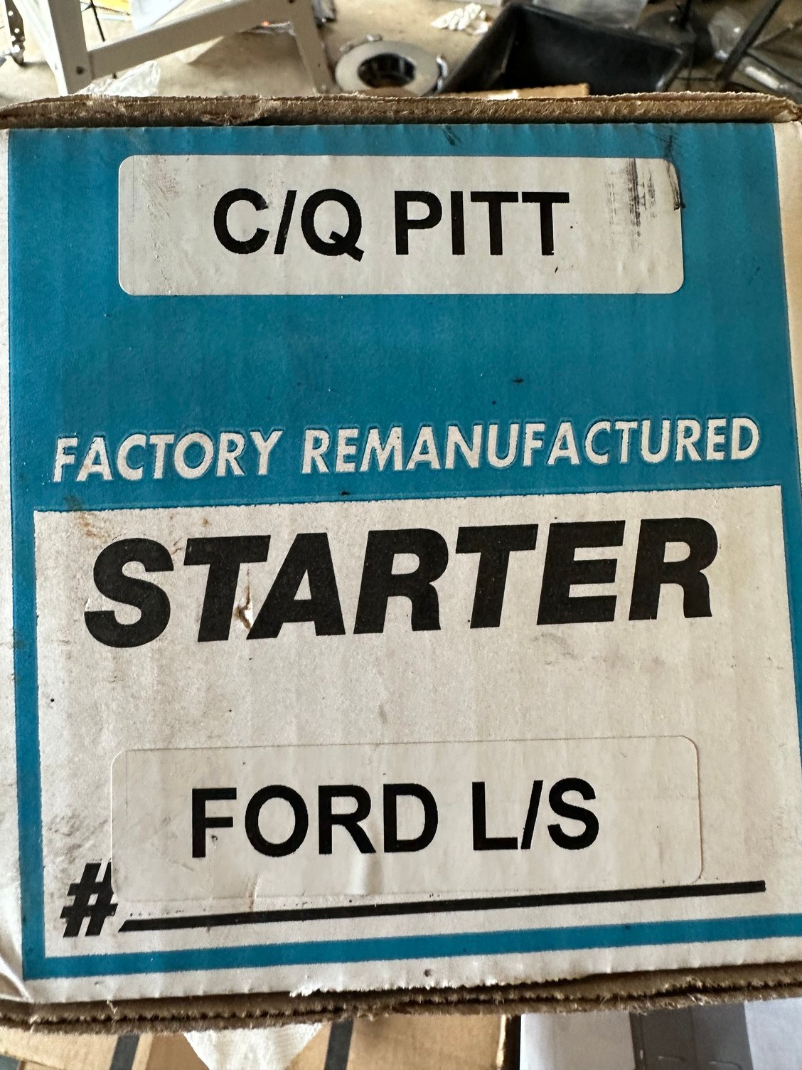

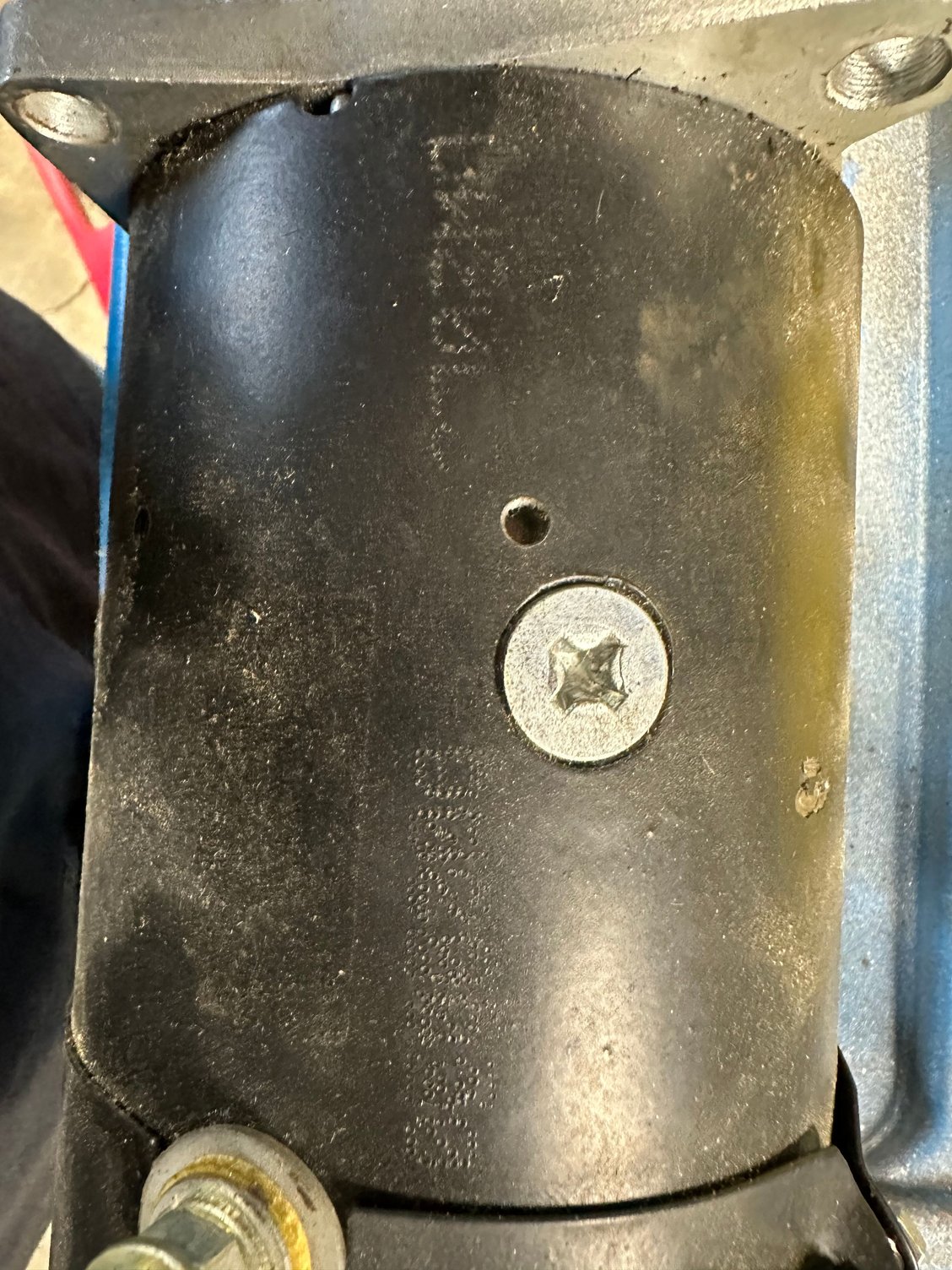

So I reviewed your pictures of the starter here: https://www.ford-trucks.com/forums/1...l#post21579190
That starter box has no part number on it, and the DW20LS doesn't match anything I can find.
It looks the part of the correct starter, but there are no readily available tells on if that is a 6V or 12V starter.
You can try to see if the starter behaves better on 12V as generally, you can always apply 12V to the starter ALONE by connecting an independent 12V power source to the chassis and (instead of a starter button) temporarily to the starter terminal (polarity of either system does not matter as it is independent). Just don't use the starter button (but DO leave the key in "run" so your 6V system powers the ignition system for spark) or you will backfeed 12V back through the starter relay and potentially cook 6V components.

The label is 4 years old and when I search the Carquest website, that number and part is no longer listed. I can't verify the part or application there. When I plug in the year and model application the starter that does come up says 12v. That could be an issue. How long have you have the starter?

Wayne, I think the ALB4450 is a shipping/inventory label suggesting it went through Albany NY on its way to/from Pittsfield, MA and not a part number.

Open it up and count the field coils, I believe the 6 volt starter should have 2 coils and the 12 volt has 3. I could be wrong but that’s what I remember after many years ago working on them.
Yes, that is true, but can be quite the effort.

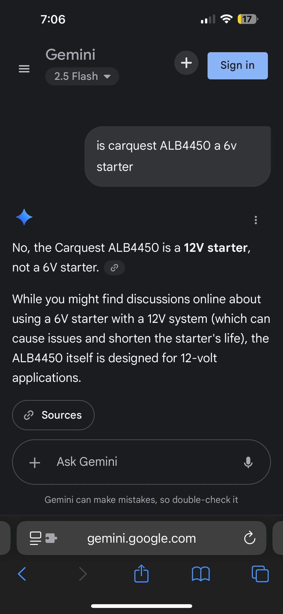

I have had it since 2021. I think it must be a 12v starter. Google Gemini (AI) says it is 12v and based on what you guys have found and said that is probably right. Will order a 6v tonight or tomorrow from Discount starter. They list 4 that will fit and it is hard to tell what makes any of them different.

Don't trust AI. Here I gave it bologna part numbers and it confidently made assertations that make no sense:

I definitely don't trust it! But sometimes it can help validate other data points. I had actually asked it the same question 4 other different ways than the one I posted to see if I got the same answer and not any nonsense.
I don't trust anything that is produced by google or any other search engine or AI at this point. It is all just information to be sorted through.
That sounds logical. So there is no part number to cross reference unfortunately. The only real indication is the Ford L/S on the box which would suggest a later model year starter and therefore 12v.
I found a carquest starter on advance auto parts that is listed as fitting my truck but the specs show it as 12v. It looks like the one I have. I suspect when my neighbor ordered it they said it fit based on the "book" but didn't verify voltage.

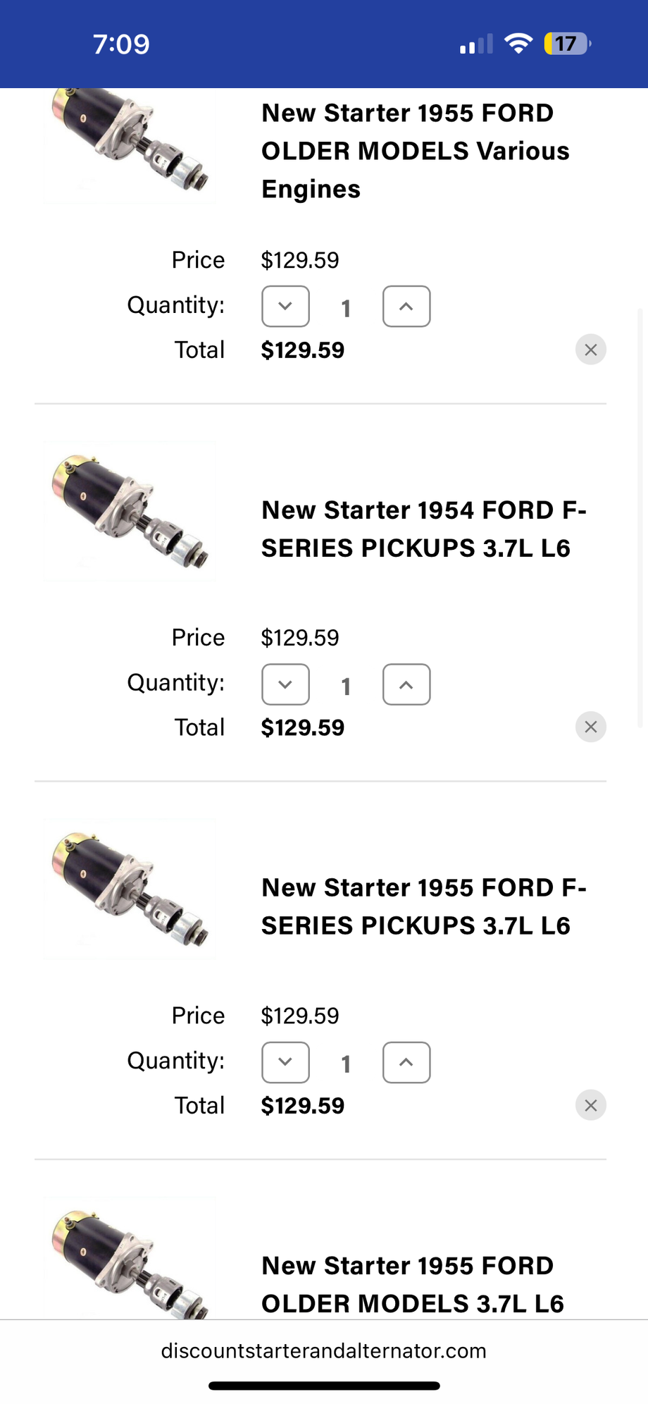

There are lower priced alternatives out there:
https://shop.advanceautoparts.com/p/...23s/99994412-P
https://www.discountstarterandaltern...rious-engines/
Amazon Amazon
