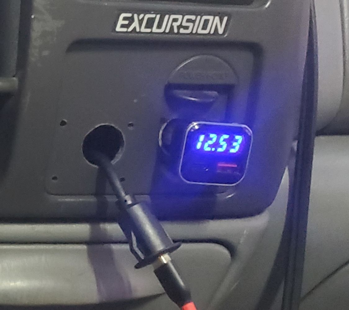

I bought the MechMan 340 amp, Internally regulated Alternator.
I just wait until I see the Glow Plugs are OFF,
before I start the engine.
I monitor the PowerPort voltage to see when that happens.
it will drop to 11.5 or lower when the glow plugs are ON.
when it rises back up 0.2 volts, I hit the starter.
