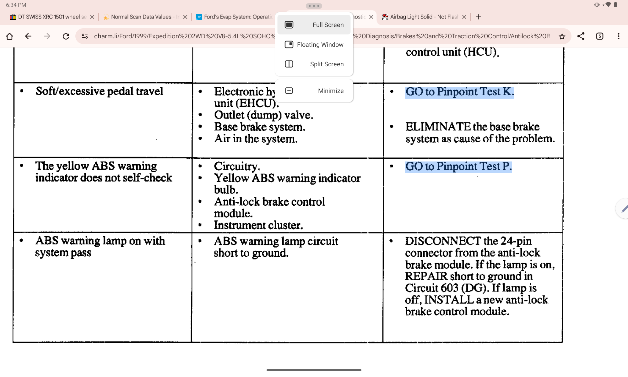

Here is a link to the service manual
https://charm.li/Ford/1999/Expeditio...%20Inspection/
Some troubleshooting.
