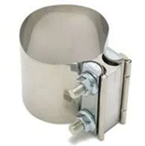

I've got headers on my 360 FE and the triangular flange that attaches to the exhaust downstream is taking up too much room on the driver side (too close to the trans shift linkage). I'm wondering if anyone has ever cut that triangular flange off and instead used a sleeve clamp to attache the exhaust that heads to the back of the truck. Lots of cars I repair use these (volvo, dodge) ...
Anyone run into this problem and have a solution if the sleeve idea doesn't work?

Sleeving it would be a good solution. If you have an exhaust pipe chain cutter that will fit in the area. Measure the OD of the collector to see what will fit and with a good sleeve clamp and exhaust sealer should work.

I would muffler-clamp exhaust pipe to a collector tube if I had to, but it's not the most ideal solution, unless maybe if you use nice stainless steel standard band-clamps. I assume that the V-band clamps, the ones which semi trucks and turbo guys use, are the best.
Functionally, I'm betting that a clamped on exhaust pipe is going to go the distance, long after the standard header flange has blown its gasket.

Measure the collector OD after cut, then measure pipe OD, get steel adapter that increases from pipe to same as collector OD, weld or clamp that to the pipe, then use a SS strap type connector clamp.
These clamps do not permanently clamp unless you just leave them in place, they do not crimp the steel pipe or collector, no harm. They work if sized right too.
Old Jul 14, 2025 | 02:14 PM

yes this is exactly the sleeve I've got in mind. I figure I can run straight pipe to ahead of the muffler then reduce as necessary.
