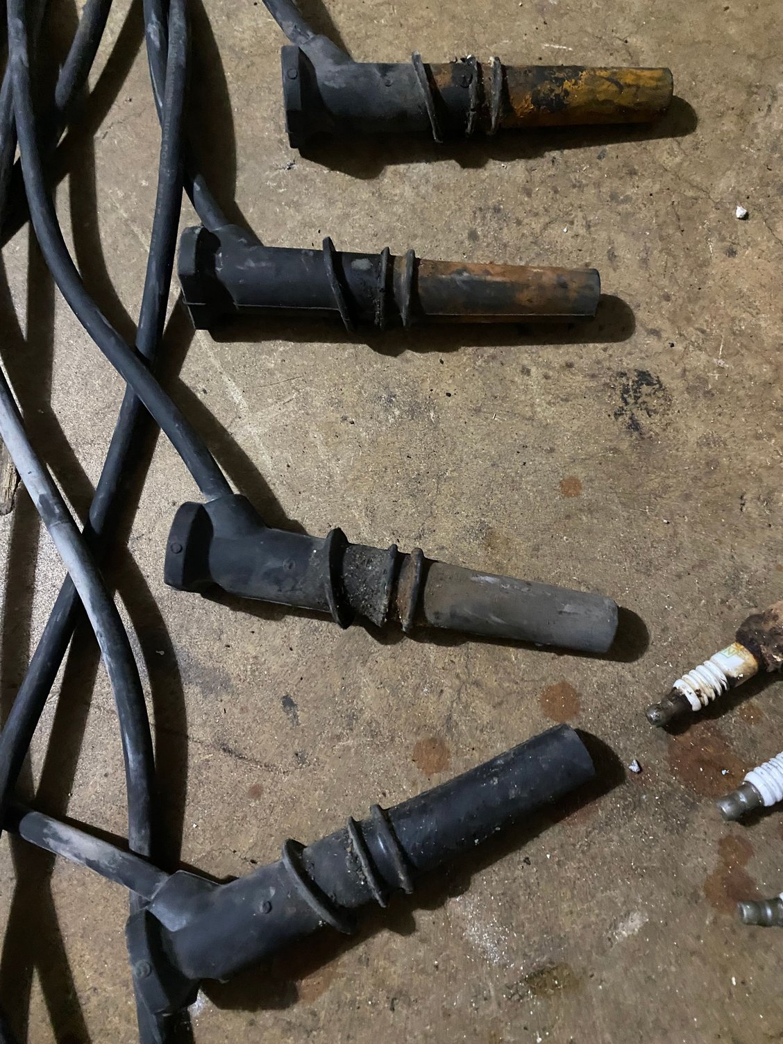

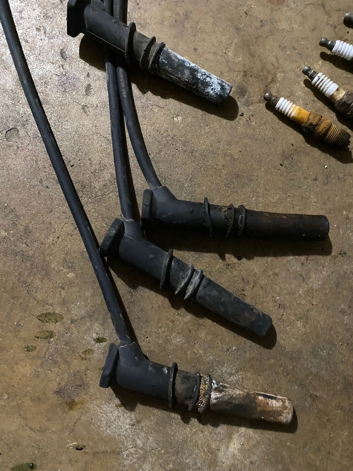

The plugs were ngk. Replaced with motorcraft. Some of those ports were full of crud. Now it idles normal and revs fine but still misses under any type of load. Not giving any misfire codes, just a p1000 and a code for a blend door actuator and a wiper switch. Got some coils coming in Wednesday. 97 F150 4.6L.

I think he was referring to spark plug wells full of crud. It can get past the plug wire "boot" and get in there and harden almost like concrete. Makes getting the plug out a lot more work.

Yea it was cyl 4 I had to stick a screw driver down in there and break up some stuff before I could blast it out with air. The socket wasn't grabbing anything, I had to use a mirror to verify the plug wasn't broken.
