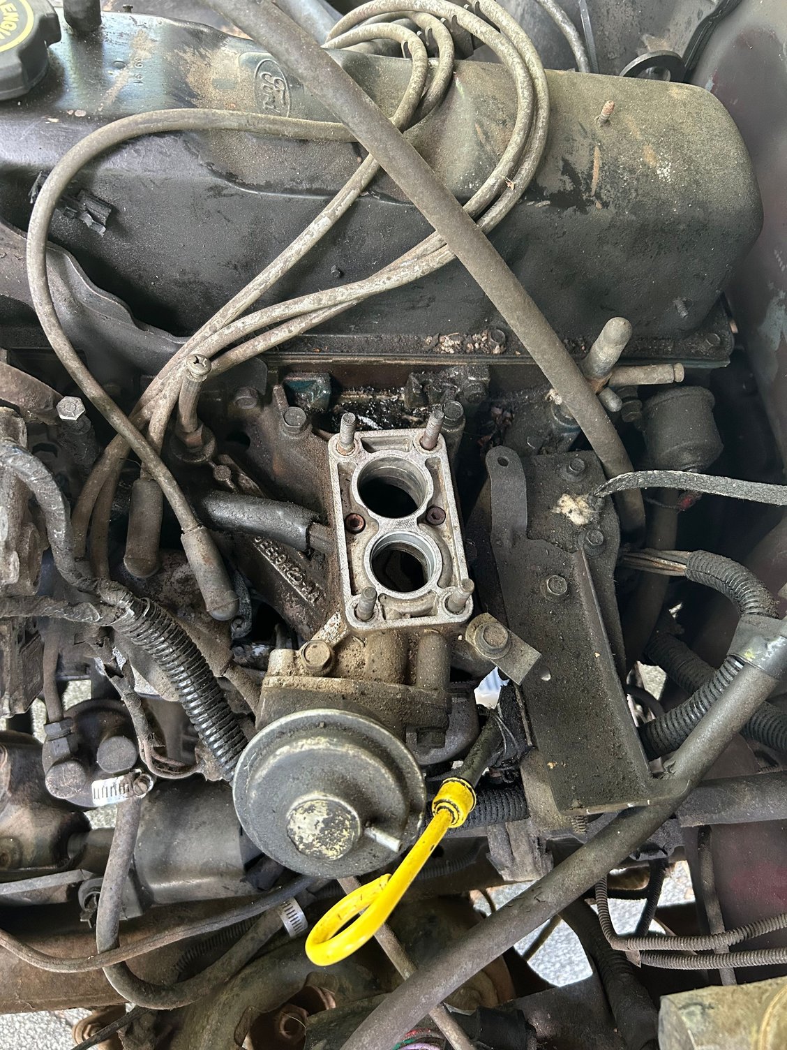

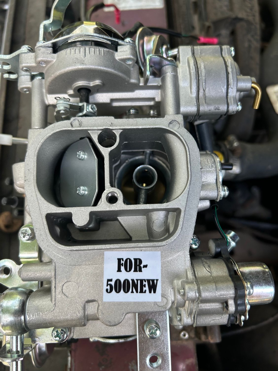

Hello all! I recently came into a 1988 Ranger with the 2.0L Engine. Bog standard everything so nothing fancy. The old carb was leaking pretty bad so I decided I would rebuild it but when I got the kit for the truck I discovered the truck had a completely different carb in it. So I ordered a new carb from National Carburetors and the one the sent me says it is the right part but definitely doesn’t fit. I’m looking for help on what my issue here is as it’s obvious someone had modified the engine in the past Bottom of New Carb
Bottom of New Carb
Parts tag on old carb
Intake Manifold
Intake Manifold
Top of new carb
Top of new carb
New carb doesn’t fit
Bottoms of old carb
Bottoms of old carb
Throttle side of old carb
Backside of old carb
Carbs compared
Carbs compared

The old carb part number tag does not pull up anything that looks remotely like it so I am at a loss there as well. The part number for the Upper manifold is: C8EE-9245-AA but I can't find anything there either.

This might help. I'm on a computer and browsed around, and found something for D52E DB. Maybe you were thinking those D's were O's. I did but this popped up anyway.
https://www.carburetion.com/CarbNumber.asp?Number=D52E-DB&srsltid=AfmBOopYniXhqMPdhCaZeqdCTzlhARhMDuGUARq 4ms5Kl5VBkXV7evz_
Rockauto shows it as a 1975 Mercury Bobcat/Ford Pinto carb.
https://www.rockauto.com/en/partsearch/?partnum=D52E+DB
Old Jul 9, 2025 | 01:47 PM
BareBonesXL's Avatar
BareBonesXL
Joined: Jun 2023
Posts: 1,379
Likes: 383
From: WA
Might want to verify what engine you have in your Ranger. Who knows what people will do. Good luck.
