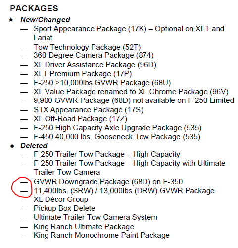

Originally Posted by 1olddogtwo
Unless something has changed again, the F350 derated to 10,000 lb Is no longer available as of the 2023 model.
I have about 14 or 15 of these in my fleet still. Prior to 2023 models, it would order at 350s with the 10K package this allowed me to have a 16k trailer for my non-cdl drivers.
My new f250s with HCTT are 11,100 so now I have to derate my 16K trailers when ordering.

Originally Posted by ATC Crazy
I thought they brought back the 10k derate? Or maybe it was the box delete I'm thinking of?
Don't have time to research it now...
I looked at my order sheet for my '25, and it shows a field for the 10k derate, which I obviously didn't take so it's not checked. However, when I get on the 'build your own' on the website, the 10k derate for an F350 isn't available. Now this is for a CCSB SRW, perhaps it's available for duallys? I didn't look too deep.

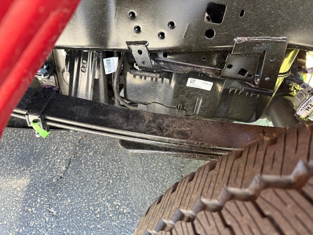

Originally Posted by acdii
F250 rear XLT
Originally Posted by TestPilot57
My F250 does not have the trailer towing package, just the 10500# GVWR PACKAGE, and I have the overload.
Interesting. My 2024 has the 10600# GVWR and just has the standard 2 leaf as pictured above.
I'm positive that the is no 10k derate option for the DRW which has a standard GVWR of 14,000
Dave
Correct. I believe there was a DRW derate option down to 13k though...They did away with it for 2023+
