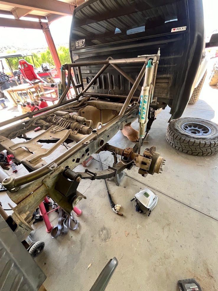

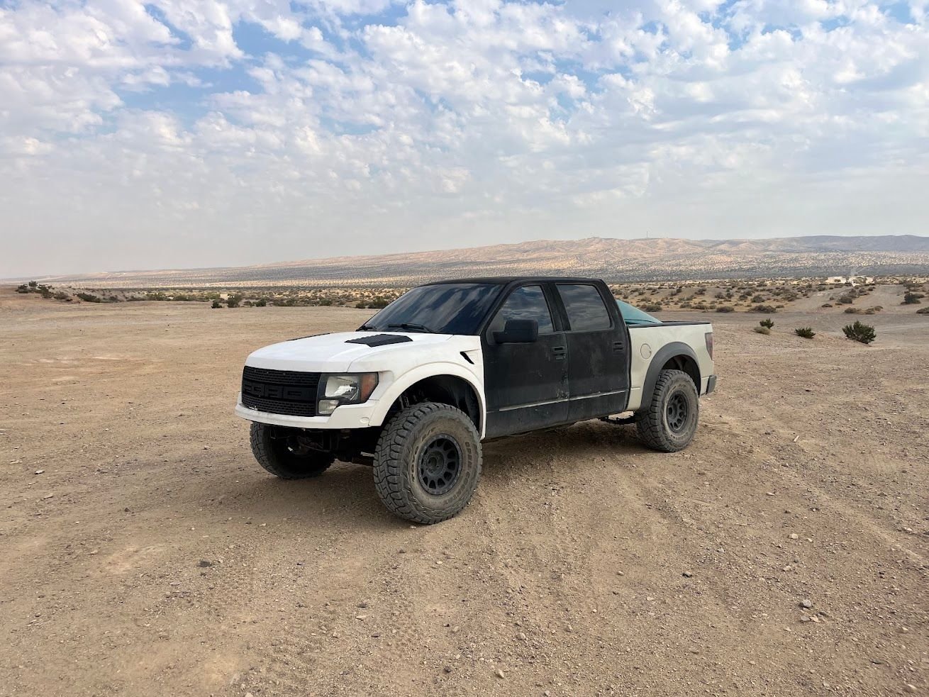

I am seeking guidance as I prepare to remove the transmission from my 2005 F150, which is no longer operational. The truck is a prerunner equipped with large 37-inch tires, and due to my demanding usage, I require a more robust solution. I am considering a 4L80E transmission and have found adapters that allow compatibility between the Ford modular engine and the Chevrolet transmission. However, I am concerned about the potentially malfunctioning without a transmission connected, as I intend to operate the 4L80E on a standalone system. When I previously disconnected the transmission, the truck displayed a transmission malfunction warning and idled at a higher rate. I am seeking advice on whether investing in the adapter is a prudent choice or if I should abandon this approach and opt for an LS swap instead to avoid the complications with the computer. However, I recently purchased a new 5.4 engine, leaving me in quite a predicament.

Nice rig.

Nice rig indeed.

Today, I a significant shift in the project when I went under the truck and disconnected the OSS sensor on the transmission and the valve body. This caused the truck to start adjusting timing and fueling, and it began backfiring. Now, I searching for a way to spoof the sensor or find a reliable 4R75E., based on what I heard and my own experience, these transmissions are generally problematic. I have already gone through two on this truck and am frustrated with them,In addition to the unreliable 5.4L engine, which I have replaced three times, another reason I considered switching to a 4L80 is that my truck has spring rear leaf and a driveline plunge issue at full drop. I was thinking of having the driveline so that it does not have the slip yoke on the transmission side.
Yes, I am in California, unfortunately, dealing with smog Do you think the transmission throwing codes will prevent it from passing?
Some better pics of what the truck has done
