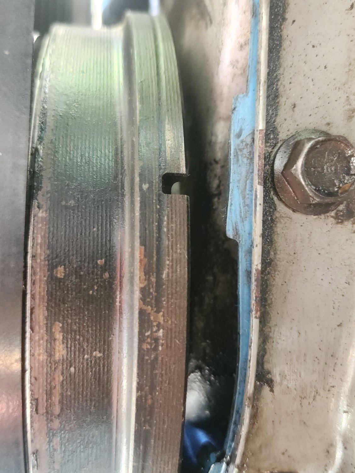

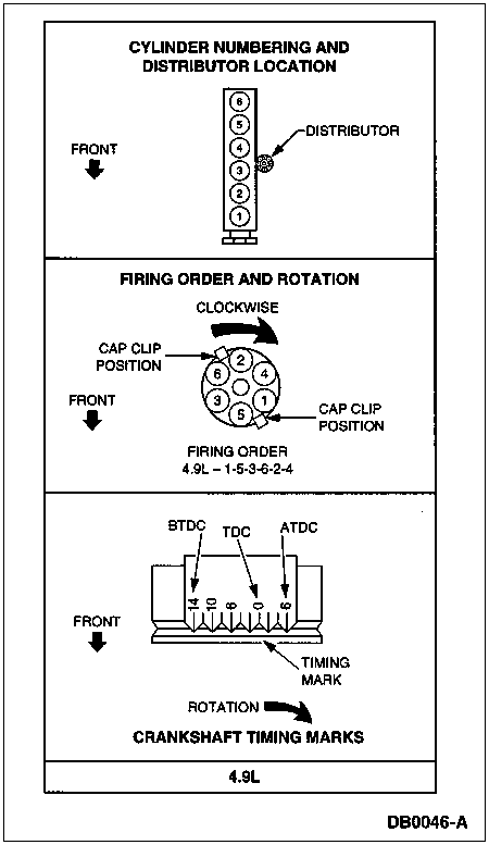

Hi do yall know which mark the timing pointer is, Im seeing a lot of different answers on the internet and want to be sure. One guy was saying its the smaller one but his looks totally different. If i you know, sweet but if you dont no worries. Thanks

-arouragirl
hell yah, that checks out thanks a lot :-)
The big notch was for the magnetic timing probe that some scopes had back in the day
The round hole in the front cover (135 degrees off from TDC) was where you put the magnetic timing probe that uses the big notch
