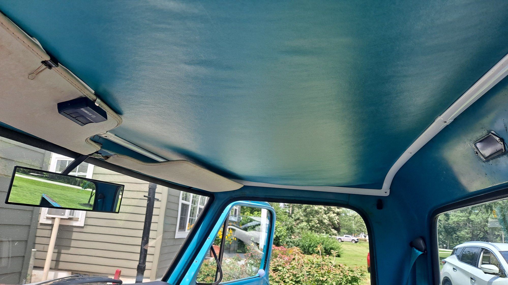

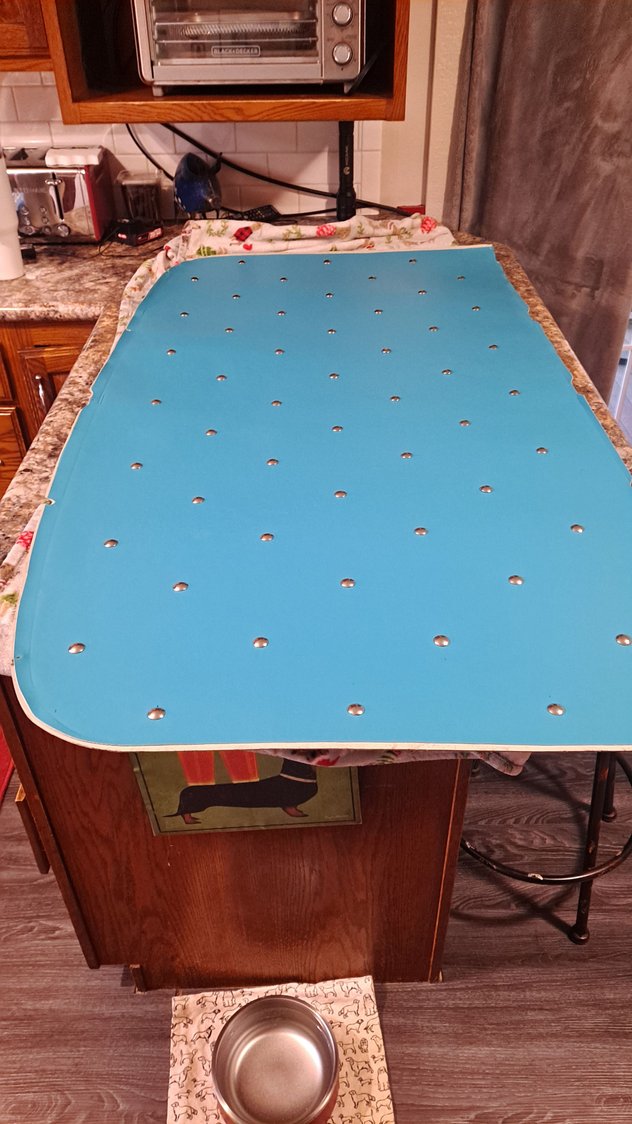

Installed a new headliner with marine fabric to match the reef aqua color on 1970 ford 100 two years ago. I used Permatex heavy duty head liner adhesive. Got in the truck last week the headliner adhesive has failed and it was drooping. Pulled the headliner off the truck and the adhesive had failed everywhere and the fabric had shrunk longitudinally 1". Used tacks and hot melt glue, hopefully that holds. Do not know if this is an isolated incident, but I would never use Permatex again, cost me alot of man hours and head aches.
