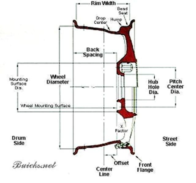

Here is a decent picture of terms.
  • Offset is how far from wheel Center Line the mount surface is, usually in MMs.
  • Back Space is an easy to measure external measure of depth on the back side of a wheel. 25.4 mms is an inch. 50 mm is 50 / 25.4, or 1.968", almost 2". 6 mm is 6 / 25.4 or 0.236", a bit less than 1/4".
  • A 255/55R17 tire is designed to be about 255 mm wide at the widest part, it will change with wheel width though. 255 mm is 255 / 25.4 or 10.04".
  • The 55 is how tall the tire sidewall is in percentage of width. 10.04 x 0.55 is 5.52", so double that and add the 17" wheel height and you have pretty near 28" overall height.
  • All are "design" specs.
I figure you probably knew most all of that, but I needed the review.

Hey thanks for this... I knew "most" of it...but nice to have the whole story in 1 picture!!
