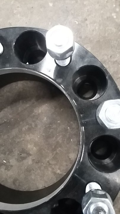

"They" do and they're out there. Once you see why the rears have to be different, you'll understand the issue. Here is an example of how thin the spacer hub must be to both fit inside the bore of the wheel and fit over the full-floating hub of the rear axle. I took this picture just now of a spacer I modified but never used before installing a later-model rear axle. This was a second set of spacers I had purchased and modified as the first set had over 20,000 miles and I sold them to a guy when I thought I was done running factory 20" wheels last year....but couldn't give them up.
Here is why the rears have to be different than the front: Note, you can also see where the pilot of the spacer rode on the rear hub as it's shiny there.
If you google "hubcentric spacer rear f250" you will find a myriad of images that show a very thin hub pilot either machined in the spacer or utilizing a steel ring pressed into the spacer. I have never personally had to machine the face of the spacer to effectively lengthen the pilot though. I do make the inner pilot diameter smaller than the axle shaft flange outside diameter so the axle shaft has to be removed to install the spacer just to leave a little extra meat in the pilot.
Here's how thick the pilots start out (from my 2wd)
