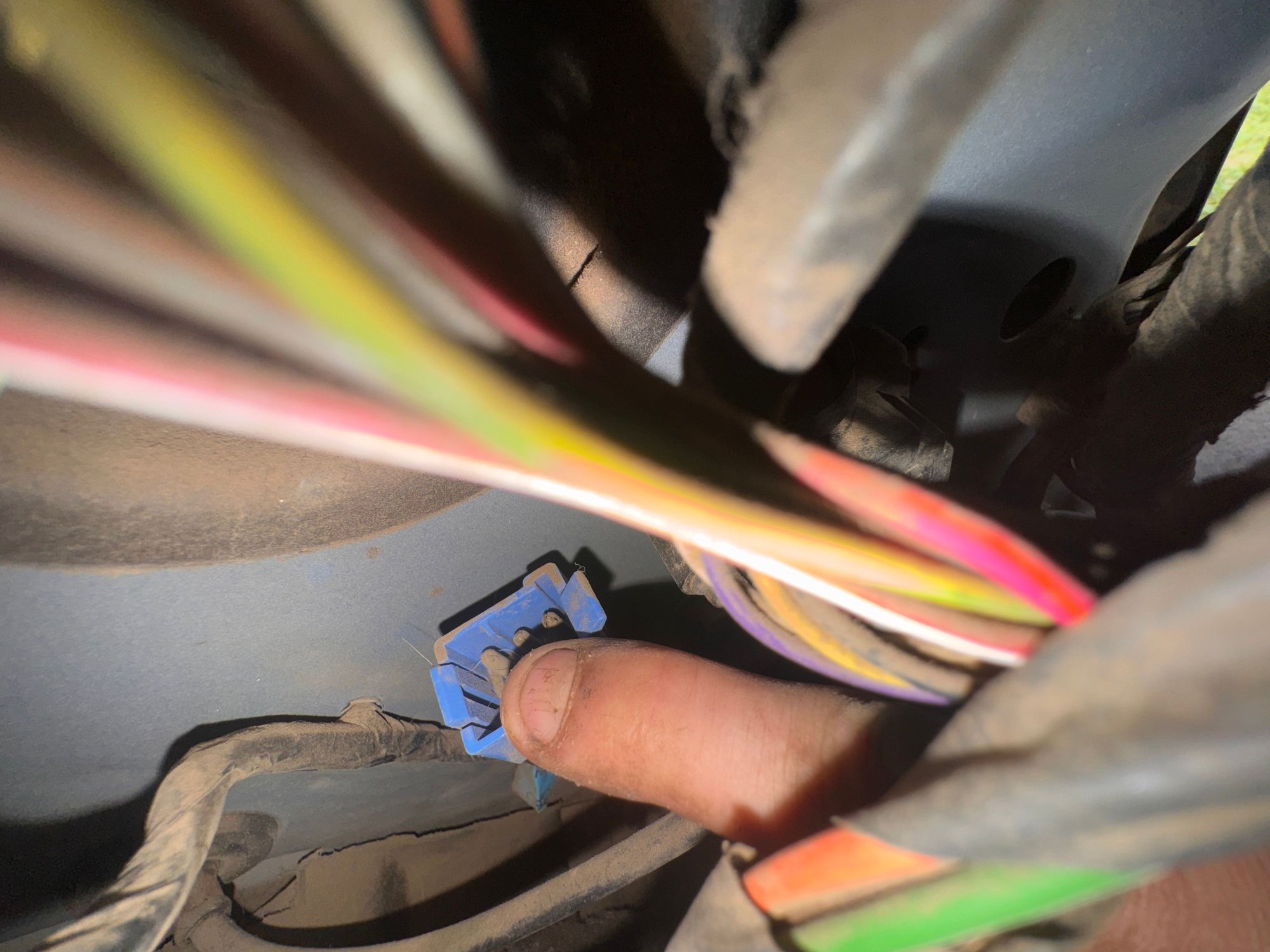

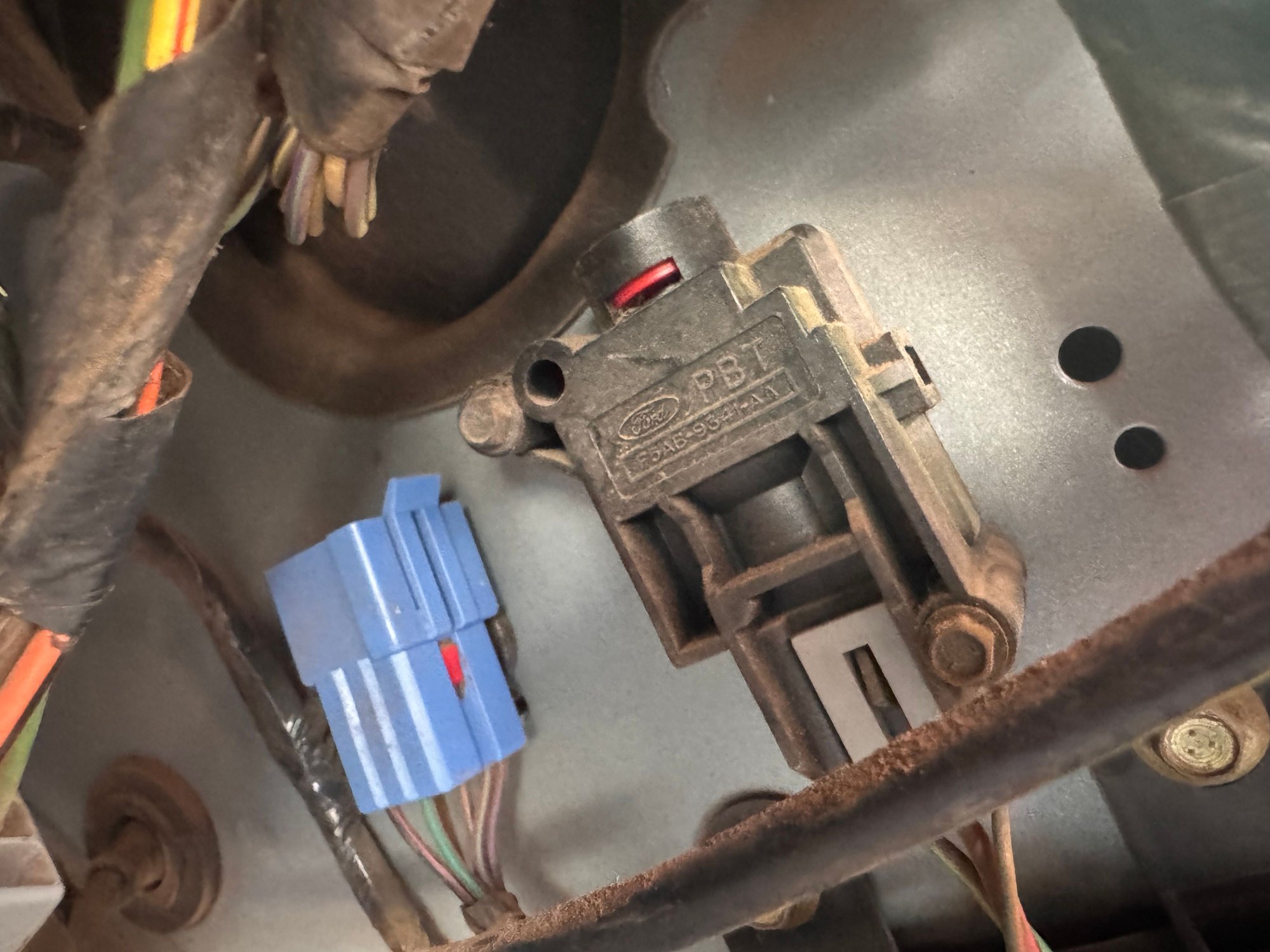

Hello I’m the owner of a 1998 f250 XLT with the 5.4 2v.
i was getting around to looking into why my ac isn’t working and noticed I didn’t have a resistor.. but I don’t think the resistor plugs into this blue connector that has part number 186574. This blue connector is located in the passenger side kick panel beside the fuel cut off switch. Any ideas to what plugs in here? And any ideas how to get the AC up and going? Doesn’t even seem to kick the compressor on

that plug is one of many that were unused yet part of a main harness that fit many combinations, IE different motors and emission combo's ,, without a wiring diagram in front of me what it was meant for i can not say,only will say don't worry about it,

Not sure what led you to the kick panel to sniff for that as no AC wiring runs there. Maybe that’s a plug for power mirror options your truck doesn’t have. Irrelevant either way.
Anyway, without being there, we can’t hazard much of a guess as to what is up. Bad control panel? Missing compressor? Low refrigerant? Missing or popped fuses or relays? Who knows.
