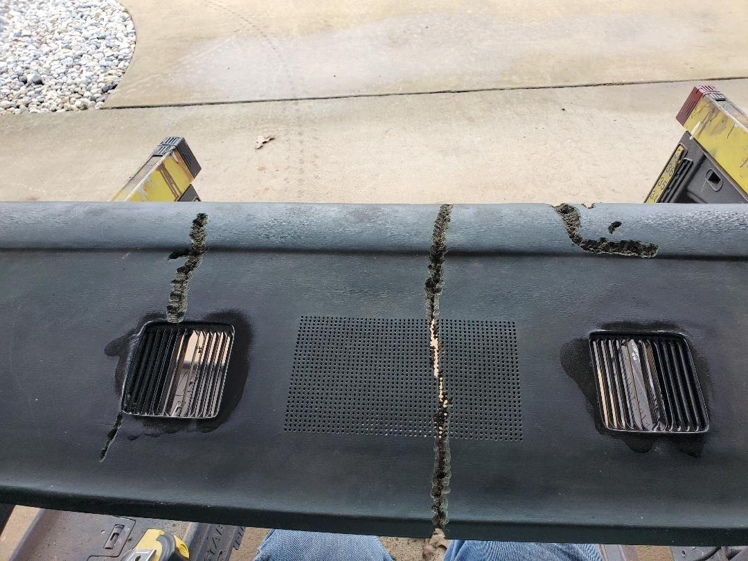

Did some playing around. Fixed the cracks in the dash. Then covered with 4 way stretch vinyl using DAP Weldwood adhesive. Still got a few wrinkles because the DAP adhered instantly. Time will now tell if it holds up to the heat here.

What did you fill the cracks in the dash with before covering w/ vinyl?

I used Polyvance Padded Dash filler for the cracks. It set up just like body filler though, so I may have done a little overkill buying that. I just did a search for 4 way stretch vinyl on Amazon. It was 14.99 a yard and took 2 yards to get the length needed.
After the fact I wonder if the corners would have come out better if I had cut the fabric and made a seam behind the windshield post.

I have a picture of the worst of the cracking, but I guess I didn't take any of the patched results. Just the ones with the vinyl already on it.

Yeah, probably not. Even if it did, it would probably be cheaper to replace the pad than to buy enough filler to do those cracks. By the time I ground out the bad, I think there would be more filler than original pad.

Now that is one interesting crack pattern.
